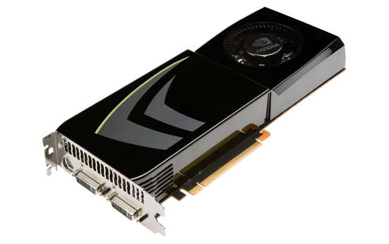

This is the Asus Mini-ITX motherboard:
And this is the GeForce GTX 285, which is a dual-width card.
It seems the card won't block anything on the motherboard itself, but the other side will protrude outside the mobo's boundary. Guess my next constraint would be the mini-ITX casing.

Reply 6 of 39, by obobskivich
Just wanted to clarify some things on the graphics hardware:
GTX 285 is not Kepler; it's GT200 (supposedly (e.g. according to Wikipedia) retroactively "Tesla" but I've never actually heard nVidia folks call GT200 (or G9x/G8x) "Tesla" - it was always GT200/G92/G80 in publications back in the day, at least that I saw). Kepler is the very newest nVidia architecture, starting with GeForce 600 series, and continuing with GeForce 700 series (except 750); GK10x chips. "King Kepler" is found on the GTX 780 or Titan parts (more technically the 780 Ti or Titan Black; Quadro K6000 could also probably throw its (*very expensive*) hat into that ring too).
More information from Wikipedia:
http://en.wikipedia.org/wiki/Nvidia_Kepler_Architecture
http://www.nvidia.com/object/nvidia-kepler.html
Kepler will have an advantage over GT200 (and the later Fermi) in terms of power efficiency, and therefore heat/noise production, but they are much newer cards (you can still buy most of them brand new). For example the GTX 660 has a TDP of around 140W, and is held by nVidia (and confirmed by external benchmarks) to be roughly equivalent to the GTX 580 (a Fermi card) in terms of performance. The GTX 580 has a 244W TDP per nVidia. The modern top dogs like GTX 770 or 780 will use slightly less power than that, and are notably faster in all regards. They will also run much cooler at idle. Here's an info slide from nVidia that shows relative performance differences:
(image is taken from this page: http://www.geforce.com/hardware/desktop-gpus/ … 780/performance)
Regarding what you have in the laptop - the GeForce 300 series is an odd duck; they're mostly OEM products based off of GT2xx (GeForce 200). Wikipedia says the GT310M is a GT218, which is reportedly the same chip under the GeForce 210 and 205. At one point in time GeForce 210s were fairly inexpensive PCIe add-in cards; I think the 205 was an OEM thing. You could probably find either of them on eBay, and honestly if that's enough performance for your needs, why not just stick with that? I remember some of them even run passively.
If you wanted to stay within the GT200 family, but go with something faster, you'd want to constrain your search to the "entry level" parts, 205/210/220/240, and the "enthusiast" parts, 260/275/280/285. The remaining mid-segment GeForce 200 cards are G9x based (not that there's anything wrong with that, but if you want to stick to the GT200 those cards wouldn't be it, per se). In general I would say G9x should be fine for what you want to do as well. In addition to the midling GeForce 200s (like GTS 250), the GeForce 9 series and some GeForce 8 series (8800GS, GT, and the 512MB 8800GTS) cards belong to that family. Also keep in mind that the GTX 285 is a fairly power hungry and hot-running card, even by modern standards.

Reply 7 of 39, by sliderider
Are you sure heat and power draw won't be an issue putting that card in a mini-ITX case (assuming you can find one that it fits)? That was a pretty powerful card in it's day. There are newer cards that are just as powerful, smaller, draw less power and throw off less heat that would be more suited to a mini-ITX system. Just doing a quick check I see that a GTX660 (not Ti) totally outclasses a GTX285.

Reply 11 of 39, by obobskivich
"They" actually make cases/boards/power supplies/etc designed around mini-ITX gaming systems. I've seen demonstrator systems with Radeon R9 295X2s and GTX 590s in the past; I think a single 285 should be workable in such a case. But you're right about more conventional ITX cases being massively out-classed by something like the 285. 660 is a very good suggestion - they run quite cool at idle, and stay very quiet overall. 😀

Here's HWCompare with benchmark #s for 285 vs 460:
http://www.hwcompare.com/8270/geforce-gtx-285 … ce-gtx-460-1gb/
Notice in the older/lighter games, like Mass Effect 2, they're pretty close. But in Supreme Commander 2 the 460 really pulls ahead. The 480 isn't a fair comparison:
http://www.hwcompare.com/8788/geforce-gtx-285 … eforce-gtx-480/
Note two things: 1) a lot of these tests are running AA and 2) a lot of these results are comparing very high FPS values on both cards, which in practice won't be discernible, especially with vsync enabled.
You should have no problems running basically everything (especially older (DX7-9) titles) with 4x-8x AA at high resolutions with the 285. 😀 Even newer games should run fine up until you run out of VRAM, system memory, or get into games that require DX11 or 64-bit OS (CoD: Ghosts and Watch_dogs are two examples).
As for ITX case, it seems I'll use either Cooler Master Elite 110 or Fractal Design Node 304, with Silverstone's ST45SF-G 450W PSU. Yes, the PSU wattage is lower than the 550W required for a GTX 285, but IIRC it's the minimum requirement power for the whole system, while the video card alone merely requires about 300W or so. Also, the folks at TechReport told me that lower wattage rating is okay as long as it's a good quality unit that supplies enough amps on the 12V rails.
I'm still open to suggestions, though.
The CM 110 will not work; it will not take the 285's length (it's too shallow - this is per CM's specs). I don't like the non-standard PSU mounting on the Fractal either (it also notes that it will have issues with cards longer than 170mm, which makes it a problem for the 285). The CM Elite 120 will work, and supports standard ATX PSUs (there's no reason to go with an SFF PSU if you aren't going with an SFF case, and since you can't fit the 285 into an SFF case, unless you already have that PSU just go with a normal ATX model). This case: http://www.coolermaster.com/case/mini-itx-eli … e-120-advanced/ (and given that size requirement, an mATX cube isn't much of a stretch).
The 450W PSU should be fine in principle - nVidia is notorious for over-stating overall power requirements (and that 550W is indeed for the whole system). The GTX 285 is 204W max TDP per nVidia (300W is more like a 4870X2 or heavily overclocked GTX 480). If it were 300W you wouldn't want to use a 450W PSU - it wouldn't have enough headroom left for the CPU, cooling, and so forth and still keep it in the mid-band for efficiency (a PSU should ideally be loaded between 40 and 60% of its rated maximum output for maximum efficiency, as their efficiency generally exists along a curve, not as a flat line). That's partially where nVidia's 550W comes from.
Something like the 650W version of this, paired with the CM 120, would be where I'd go with this build:
http://www.seasonicusa.com/G-series-450-550-650.htm
There's other good makers that will do a quality 500-700W unit, like Antec or PC Power and Cooling. In general I'm not a fan of Cooler Master power supplies (and yes I realize that you'll always find someone who's friend or brother has one and it's worked fine for years and years, but they've always been kind of a "half way to quality" brand).

Looks like a good choice of a card - PNY makes nice cards in my experience, and it should do a killer job for your games. It'll also support newer features like PhysX (no DX10 under XP, but that's not a dream killer imho).
Well the things I like about the PNY card is that it's stock-clocked, not overclocked. I'm gonna use it for old games anyway, so I won't need any overclock which, by the way, potentially shortens the card's life.

Indeed. I guess I have hit the "sweet spot" with the GTX 285. No need for shader performance, just insane amount of fillrate! 😀 (for old games, that is)
Indeed. Couldn't wait to run Crimson Skies of F-22 Lightning 3 with that card! 😀
I see, many thanks! Fortunately I haven't bought the wrong case from ebay.
By the way, case and video card I'll definitely buy from ebay, while mobo I can buy locally here. You see, premium products are quite hard to find in Indonesia. For example, you were lucky if you could find GeForce 7900 here, at most you'll find 7600 instead.
obobskivich wrote:
The 450W PSU should be fine in principle - nVidia is notorious for over-stating overall power requirements (and that 550W is ind […]
I see, thanks again buddy! 😀
