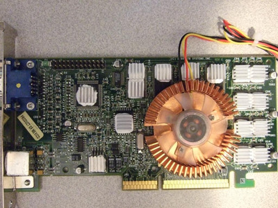

Quick update for posterity:
The original card is still dead. However, I decided to tempt fate by buying a new one and going ahead with my original mod plan.
This time, I ran the Unreal timedemo for about an hour before attempting to remove the heatsink. Success! The thermal pad let go much more easily, and evidently, no damage was done.
Here is the end result:
Thanks to RogueTrip2012 for the idea. Despite all the cooling, though, my card is STILL not stable at 183 MHZ! I guess it didn't have much headroom to begin with.

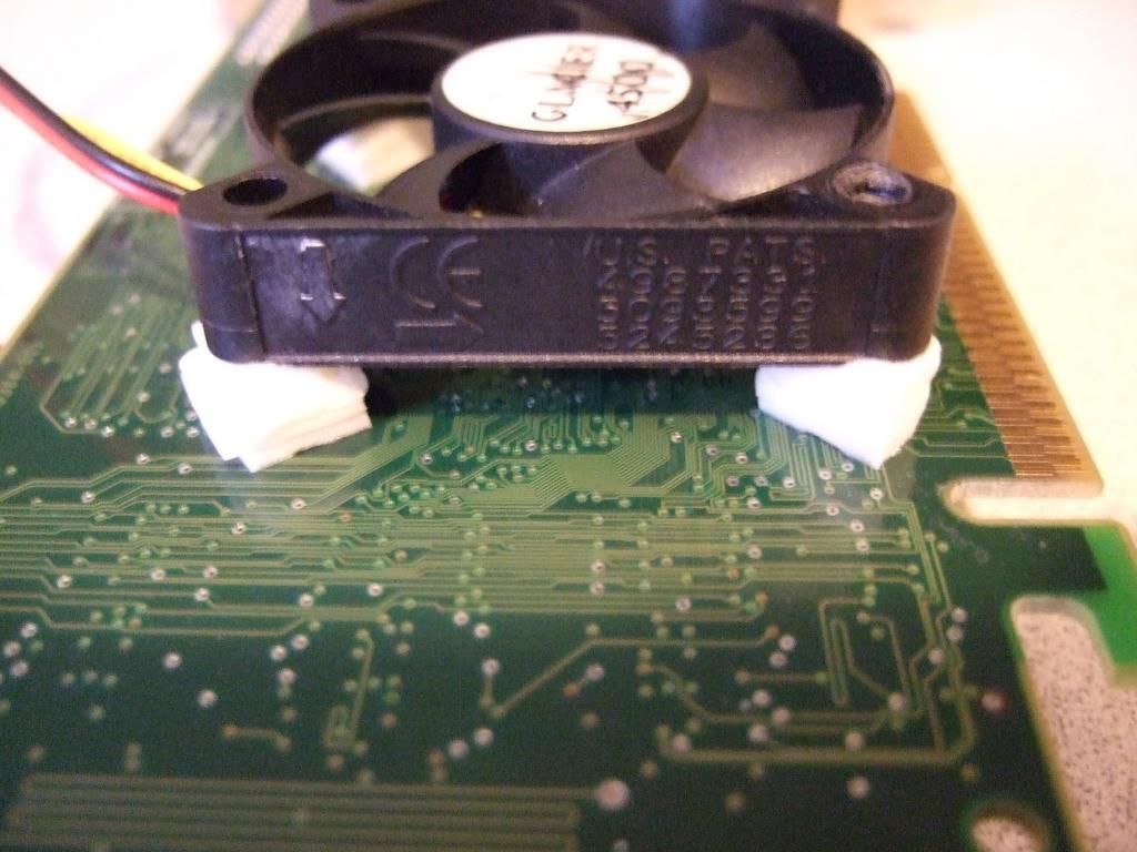

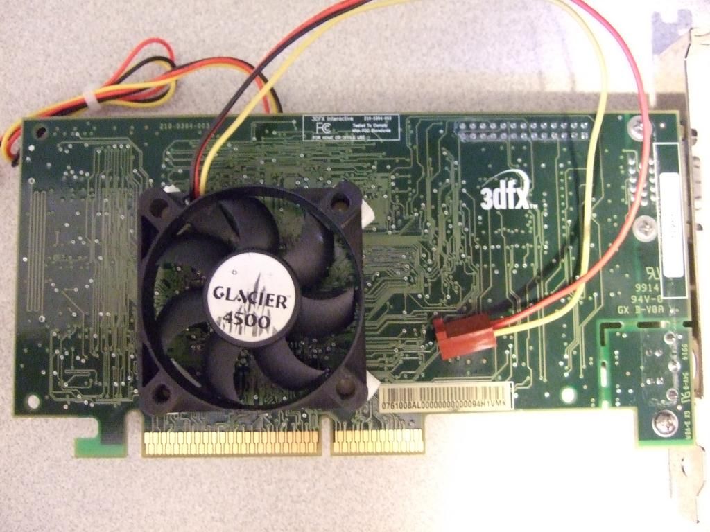

153.91 KiB

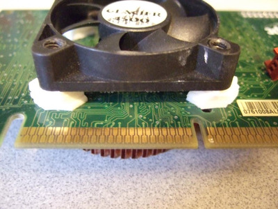

This card was a disaster when I received it. The heatsink fins were badly bent and disfigured by the previous owner. I replaced it with the Evercool VC-RE you see in the pics. I also glued the heatsinks to the RAM with Arctic Alumina thermal epoxy.
Because I never anticipated overclocking or anything else, I didn't think to line up the HSF with the holes in the board. Because of that, I had to attach the rear fan with about four layers of double-sided tape. It is very ugly, but it works. It's also very solidly attached, despite appearances.
If you're curious what a "Glacier 4500" fan was, it was part of a Slot 1 cooler circa 1999 that was sold by a now-defunct company called "Net N Dude". While the HSF is now long gone, that solitary fan lives on to cool the rear end of this ugly Voodoo 3.
