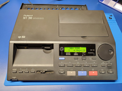

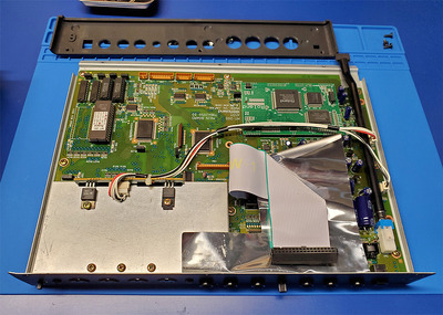

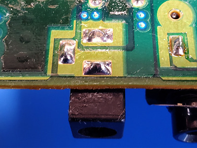

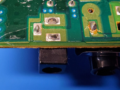

Worked on a Roland MT 200 I bought recently.
It had a wonky power connector; wiggling the cable would cause it lose power.
Figured it was cracked solder on the power connector. A quick reflow later and it works perfectly. (Also reflowed a few of the other connectors for good measure.)
Not a complicated fix, but it's one less piece of hardware that is having issues. 😀

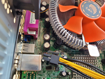

I was looking inside my PCIe Win98 box and noticed this..
The attachment Avenger Bad Cap.jpg is no longer available
Will be doing some recapping later in the week I guess.

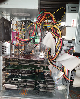

Reply 21564 of 29869, by AppleSauce
Currently working on getting my dream slot 1 build going , its being a bit of a basket case atm , some cards aren't working as they should : the voodoo 2s are showing the wrong ram values in the display settings and I need to replace a fan on a 256 gpu that I plan on swapping in for the verite 2200 which is locking up atm oh and the encore dxr2 refuses to work.
Fun all round.
So ill probably be testing lots of different drivers and trying to find the ones that work.
The attachment 20220424_221920 - Copy.jpg is no longer available

I had a surprising time with AGP and PCI cards on a Slot 1 recently - like 5 of them would only work in one system and not the other.
Standards seem to be more like suggestions than actual rules.

Is the mobo an ABIT BE6-II, by any chance? Those caps' placement inbetween the PSU and the CPU look so familiar to me.
EDIT: Almost got it, it's a BF6 that you're rocking there, basically same board as I have but without HPT366/370.

Yeah it's a bf6 , I got it from a friend in a pretty sorry state , spent many years in a garage with bulged caps.
He said I could have it and try to fix it. It was perfect for my build since it had so many pci slots.

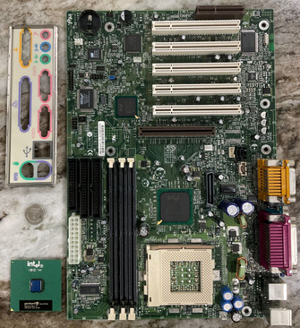

The 2nd motherboard I ever bought was an Intel D815EEA w/Pentium III@733MHz, which replaced an Asus P2B w/400MHz Pentium II. I installed it into some kind of translucent green case. I think this was during the iMac G3 "berry" rage. Anyway, this board conveniently included a 900/100MHz CPU (one of the last socket 370 PIIIs I wanted to complete the set).

Happy to know it's recapped. My BE6-II was recapped as well once I got it. Surprisingly none of the Tayeh caps were bulged.
All of them looked brand new, but considering they haven't been powered for so long (it probably has at least 15 years of no power going through it) I feel that recapping with Panasonic/Sanyo/Rubycon (used all three) was a good thing to do.
And sure it was, cause it's literally eating almost any P3 CPU I throw at it, except Tualatins (the only one being a Tualeron for which I'll probably mod a Epox EP-3VCM to get it running) and SL5QW CPUs (I have two of them - neither POST'd on the BE6, both POST'd on the Epox.) and for the latter I haven't found any solution yet - it's a Mendocino slotket that I modified so I'm not expecting much.

That's a nice board 🙂
You gonna use it in a build or did you get it just for the processor?

Thank you! I have big BIG plans for both - I foresee they will end up in several different cases 40o different times over the next several years...

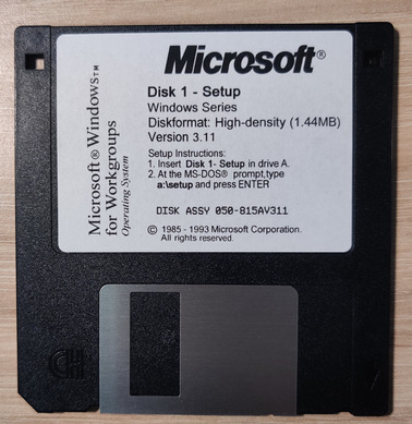

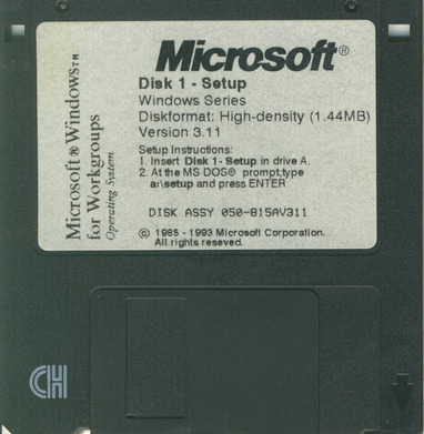

Created my Windows 3.11 WFW 8x floppies set 🤟
The attachment 2022-04-27 20.04.27.jpg is no longer available
Comparison between mine and official one :
The attachment 2022-04-27 20.05.24.jpg is no longer available
The attachment media-disk01.jpg is no longer available
That's quite good! What are you using for labels?
