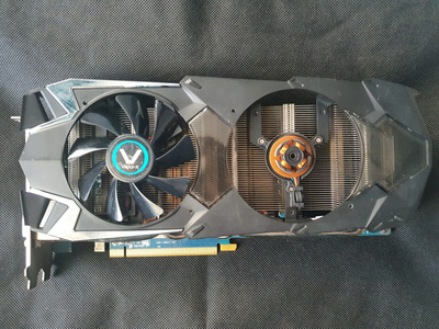

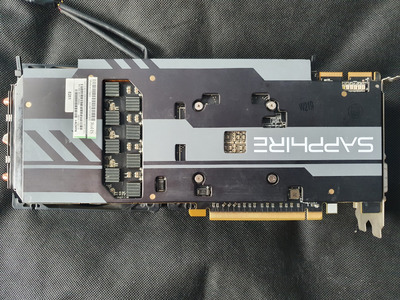

Reply 22701 of 25360, by Radical Vision
Not really retro, but old activity..
Installed the stock coolers of my R9 280x VaporX and R9 280x Toxic, they had missing fans and shrouds, so when is aw local ADs i did purchase dead cards, but with well working fans, to install on my cards, and making them as they should be. I even managed to revive the artifacting VaporX, and did buy another cooler for it, so i have now extra VaporX, that will be sold, the card is working great did test it multiple days for like 2 hours per day, and no crashes, artifacting or any crap going on..
Did install also X-Fi Xtreme music to the x58 system, the card works great, no craclikng, buggy sound or anything. I think that card did even improve the performance in Prototype II and GTA V, since before installing it, the games did run well, but there was some sort of microsttuter, now with the X-Fi there is not. The interesting part is that, this is the Music card, not the Gamer or Fatal1ty, as they have more memory for gaming. Some ppl did state that this memory on these X-Fi cards is BS, but it appers, that they improve the performance of the sound, and with that the games run smoother as well...
This is how the cards did look before adding the factory fans and shroud...

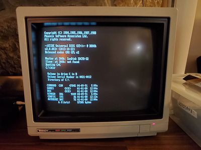

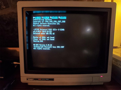

Reply 22703 of 25360, by Shponglefan
Did some more tinkering with the Tandy TL/2. Tried it again with the CM-11 monitor and this time it worked fine. No idea what the issue was originally, maybe just a loose cable?
I tried installing an XTIDE board to be able to use my CF card with it. Unfortunately this is where I ran into further trouble.
The CF card I had setup on my Tandy HX would only boot half the time in the TL/2. And then running a DIR, it would hang when trying to report back the disk space remaining. It's only a 32 MB card and works perfectly on the HX, so not sure what the issue is here.
I also ran into issues trying to boot from the floppy drive. Multiple DOS 5.0 disks wouldn't work and only a DOS 3.3 disk worked (and even that failed a couple times). Once I got the 3.3 disk working, I tried using another CF card (128MB). I was able to partition and format it, but then it wouldn't subsequently read the card at all.
So I'm not sure what the issue is. Do I have a defective XT-IDE board? Is it something else in the system?
I may try the XT-IDE board in my other Tandy SX system to at least confirm whether it is defective or not. At which point, I can then tear down the TL/2 for further inspection and testing.

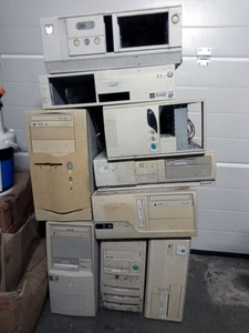

Today, recovering treasure from the dumpster landfill.
It was literally outside in the rain..
For an upcoming "Trash to treasure" project.
I will post some pictures of the progression.

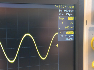

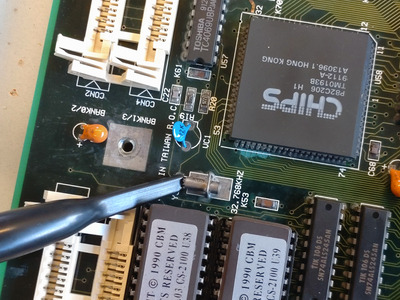

Troubleshooting the PPM 1660C board from a Commodore Business Machines 386SX-16.
Early Phoenix BIOS, 2 long 3 short beeps.
Crystal seems good, think its for the RTC. It must be 'cause I recognize them from cheap digital watches you could win at the local carnival I use to 'dismantle' not long after.

PD2JK wrote on 2022-09-19, 17:45:
Crystal seems good, think its for the RTC. It must be 'cause I recognize them from cheap digital watches you could win at the local carnival I used the 'dismantle' not long after.
Brand new 😁
Or that maybe also come from the oxidation visible near of the Chip.

Reply 22710 of 25360, by pentiumspeed
Chips P82C206 chipset is notorious for failure rate. I suggest replace that with any 82C206 chipset like SiS, etc.

Reply 22711 of 25360, by Veeb0rg
80386SX wrote on 2022-09-19, 16:55:
Today, recovering treasure from the dumpster landfill. It was literally outside in the rain.. […]
Oh man, great find. I've been looking for a desktop case for a little while now. I'm jealous.
Reply 22712 of 25360, by PD2JK
pentiumspeed wrote on 2022-09-19, 18:29:
Cheers,
Thnx man, I found an UMC UM82C206L at the bay and made a proposition...

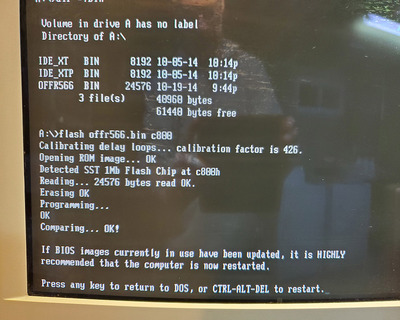

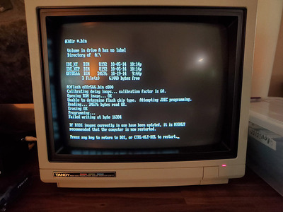

Continued to struggle getting CF to work with the Tandy TL/2. In researching the issue, a suggested solution was reflashing the BIOS on the XT-IDE card with an 'offset' version.
Unfortunately this did not work as every single time it hit byte 16384 it would fail writing. I tried repeatedly using both the TL/2, plus several attempts using a different 386 machine, same result each time.
It would also fail to write the IDE_XT.bin BIOS, only that would fail at byte 0.
At this point I'm wondering if maybe there is something defective with this particular card (maybe the memory chip?). At any rate, I placed an order for another Lo-tech XT-IDE card, plus a couple Blue Lava Systems XT-IDE cards.
We'll see if I have better luck with those.

Reply 22714 of 25360, by 80386SX
Shponglefan wrote on 2022-09-19, 21:09:
Continued to struggle getting CF to work with the Tandy TL/2. In researching the issue, a suggested solution was reflashing the […]
What is the reference of the BIOS chip ?
Often OTP chip are used - so we cannot reflash it (except the UV erasable model if you've and UV eraser). Maybe it's your issue to flash it ?
Else you need tu buy a flashable eeprom (non-OTP), with a true eerprom programmer like a TL866-II.
Reply 22715 of 25360, by 80386SX
Veeb0rg wrote on 2022-09-19, 20:19:
I must admit that I thought I was in a dream when I saw all this pile of towers 😁
There were twice as many, I think I took the best ones.
Anyway, nothing would fit in my car. On the other hand a lot of rust everywhere. I think most of them still run but there is work to do 😀
Reply 22716 of 25360, by Shponglefan
80386SX wrote on 2022-09-19, 21:18:
It's supposed to be designed to be flashed directly from DOS via their flash application. The memory chip is covered in a giant "PC Rear ->" sticker, so I don't know what they used specifically.
At any rate, I was able to get it to work. Turns out I was missing a step whereby you remove a jumper to disable the ROM, then re-enable the jumper after the computer turns on. This worked and I was finally able to flash this bloody thing.
Unfortunately, while the flash process worked and the card now reads the BIOS at address CC00, it completely fails to boot anything (either floppies or my CF card). It just hangs on boot, no matter what I try. So it's now even worse than before. 😒

Reply 22717 of 25360, by 80386SX
Shponglefan wrote on 2022-09-19, 21:45:
It's supposed to be designed to be flashed directly from DOS via their flash application. The memory chip is covered in a giant […]
It's look like a tired eeprom Sir.
Maybe you have to peel the sticker to buy the same reference to flash it with a programmer.
Reply 22718 of 25360, by Shponglefan
80386SX wrote on 2022-09-19, 22:00:
There is a BOM available for these boards: https://www.lo-tech.co.uk/wiki/XT-CFv3#Bill_Of_Materials
At any rate, I've ordered a whole replacement board, plus a whole different CF flash adapter. Once I have a few options in hand and can better do process of elimination in terms of anything defective, I'll revisit trying to get this to work.
