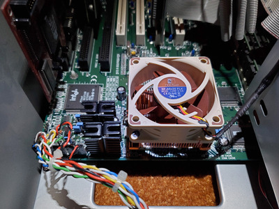

Upgraded my Pentium 120 system to a Pentium 133.
It may seem a bit silly, but I prefer the look of a "133" on the front of the case. Plus, I wanted to specifically go for a spec of processor that represented peak gaming in late 1995/early 1996 just before the advent of 3D acceleration.
Also upgraded to a modern StarTech socket 7 copper heatsink and Noctua NF-A6x25 FLX 60mm fan. Did have some trouble with the StarTech's stock clip as it wouldn't latch to the socket. Ended up cannibalizing a clip from an older heatsink to get it attached.

Generous heatsink you could run a late 75Mhz pent at 133 under that. 🤣

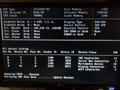

Mildly disappointing day of testing.
None of the s478 boards posted. Some spun the fans.
None of the Socket A boards posted. The ASUS did spin the fans, the AsRock did nothing. I still hold on to the hope that a recapping might fix the ASUS.
As for the Socket370 board, I also took the leap of faith with that and it initially worked fine, booted into Windows 98 with my CF.

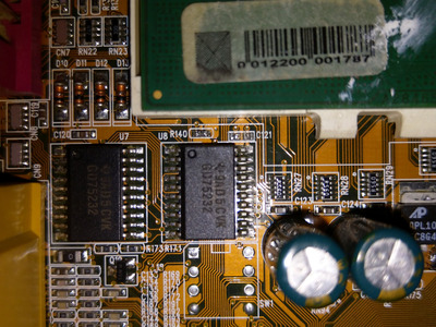

Successfully tested the expansion cards. Except for the last one. When I tested the last one, the Radeon 9600, it was artifacting. It had a loose leg on a VRM chip which got soldered back on. Next time when I started, something popped and the board no longer posted. The only damage I found was a small cap which popped off that seems to have been connected to a serial controller.
989.83 KiB
1344 views
As for the cards:
SB0100 - Works as intended, sounds fine.
Radeon 9250 AGP - Works as intended, the heatsink is a little hot, probably needs new grease. 49fps in Quake III Arena (GoG, timedemo).
Radeon 9250 PCI - This joined the party today, works as intended, also needs fresh grease, 43.5fps in Q3A.
I don't know if this last board was actually killed by the R9600 or something just happened to give out right then and there. The graphics card doesn't seem to be shorted when checked with a multimeter and the part where the cap was blown off has nothing to do with the AGP port.

I don't know what S370 board that was but it is entirely possible that the R9600 drew too much power from the AGP port for a Socket 370 era VRM to handle, particularly when it is 30 years old..
Reply 23111 of 27549, by RandomStranger
It was this OEM board:
http://pb.retropc.se/luna.html
https://theretroweb.com/motherboards/s/msi-ms-6323-v1.x-va3

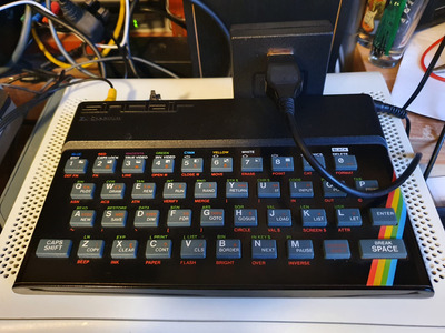

Today I built another computer...
299.74 KiB
1288 views

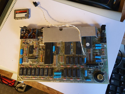

Well ok, I technically just fitted a recently purchased Issue 6A motherboard inside an empty Spectrum case that I had, it counts as a build right? 🤣
361.83 KiB
1288 views

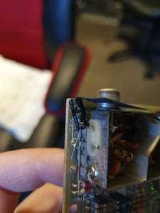

I bought this motherboard knowing that it had an issue with the RF output (probably failing capacitors), but I didn't care as I was going to composite mod it instead. I used a 100uF 10V capacitor, as most of the guides suggested.
163.53 KiB
1288 views
The result is a fully working Sinclair ZX Spectrum 48K, outputting via Composite. Tested loading games via my phone with PlayZX, as well as with a divMMC. I'm happy to finally have a 48K Spectrum in my collection, just for it's iconic looks mostly. I already have a Spectrum +2B in my collection since I was a kid, I'd just never owned the original rubber-keyed 48K model before and this was quite cheap overall!
This motherboard has been fitted with a reset switch, connected to the white wire pictured. I currently just have it sticking out the case at the back and mounted with blu-tack until I decide what I'm going to do with it. Nice to have a reset button, rather than having to switch the computer off and on from the plug socket!
Now I must resist performing any further mods or tweaks to it unless I absolutely have to.

IIRC the very first Socket 370 CPU was the Mendocino Celeron released in August 1998 so even the oldest S370 MB is no more than 24 years old.

I would assume that your checked for solder bridges with a multimeter after your repair. A bridge can very easily be invisible to the naked eye.

Congrats! I have myself a zx issue 3b to which i added the composite mod, and in i hope in this year i will do the dc-dc mod. Thankfully the cables of the keyboard are still good, it was very little used it looks!
How do you load games and/or programs? Do you use a cassette player? Phone app?
Reply 23117 of 27549, by PTherapist
Martin85 wrote on 2022-11-10, 22:38:
I'm primarily using an old Android phone with the PlayZX app. That app isn't so great for multi-load games, as there's no way to skip back or forth, so it's easier to simply convert those to WAV and play in a normal media player app.
I do have a divMMC SD card solution for instant game loading and it works well, but I'm favouring that for my 128K+2B Spectrum instead.
