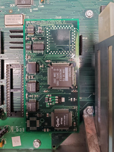

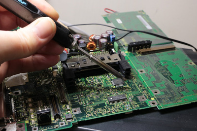

I was trying to fix my Toshiba T2130CT and something went wrong, the board no longer powers up and a replacement board is £22. So it's time for a new board rather than troubleshooting further (I think the board did this when I first got it so nvm). The only board I could get was a DX2-50 instead of a DX4-75 and that's unfortunate so I have to make it go faster 😀
While everything's apart this is not too tough to do, it requires removing the PC card slot which covers some jumpers that control the PLL that sits on the other side of the board.
432.56 KiB
1676 views

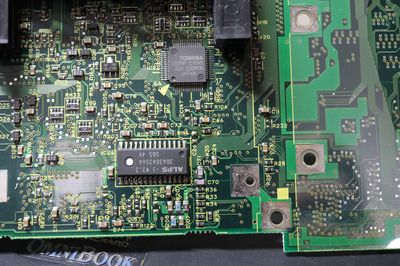

This info comes from a now defunct japanese website that never got translated and I don't know of anyone wanting to overclock 20 year old laptops these days: https://web.archive.org/web/20120513160512/ht … ance/gt475.html
It requires moving the little 0-ohm resistor from W35 to W6 and the bus speed goes from 25MHz to 33MHz, making it a DX2-66 which seems to be running well enough:
698.28 KiB
1676 views
307.02 KiB
1676 views
If you want to speed up an old Toshiba laptop from the 486 to Pentium MMX era, this website's got some excellent information: https://web.archive.org/web/20120707221419/ht … jp/performance/
I considered doing something like this to speed up one of the Pentium based satellite laptops but it's more involved.

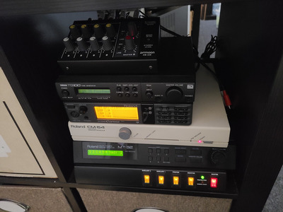

I finally took the time to get my MIDI stack hooked up.
618.62 KiB
1612 views
I was going to buy a bunch of fancy cables to keep the wiring all pretty and tidy, but in the end just got a bunch of the cheapest 1.5' RCA cables and RCA to 1/4" adapters I could buy and I used all the original (slightly too long) Roland MIDI cables I had on hand to hook everything up. Saved a ton of money, and once everything was hooked up with the 50 extra feet of AC\DC adapter cords all tangled together, I was glad I didn't try to beautify that side of the stack. It's hopeless. 🤣
How about that color match on the power center LEDs though? I think it looks so cool. And yes, the switches work in order. Mixer on "Master", and each module has it's own switch from right to left, top to bottom of the stack. 😀

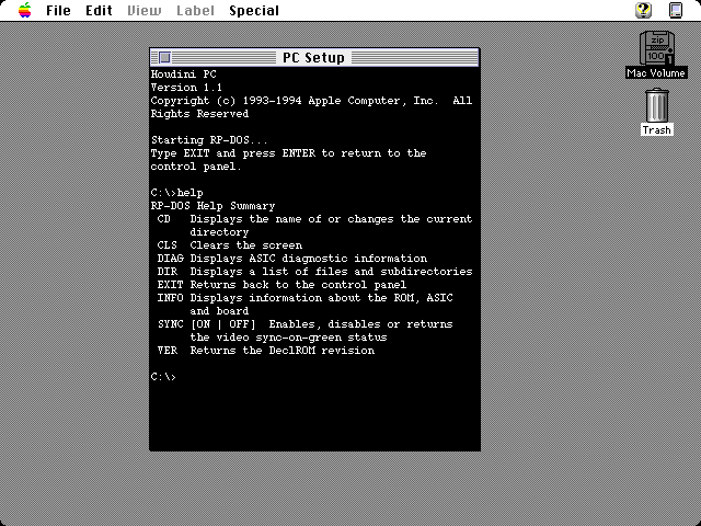

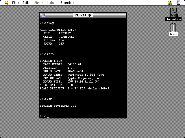

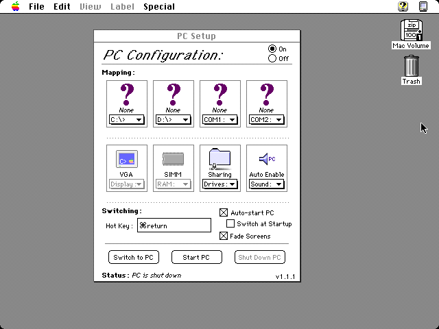

Played around with Dos compatible cards in a PowerMac 6100.
7.91 KiB
1475 views
8.75 KiB
1475 views
7.55 KiB
1475 views
Tried some serial nullmodem multiplayer games, Doom and Descent to name them, between the Mac Dos card and a Compaq Armada 1592.
And tried some OSes other than Dos/Win 3.x which the card only officially supports, some do work, like Linux running entirely from a ramdisk, V2_OS and the QNX 3.03 demo floppy.
Others don't, any regular Linux distro that requires accessing the drives, as in needing a root floppy for a multi floppy mini distro or loading root from the hdd
etc,
QNX 4.05 demo just hangs in there not loading after displaying "Q",
Tomsrtbt doesn't load either, maybe a problem with using a superformatted floppy disk...

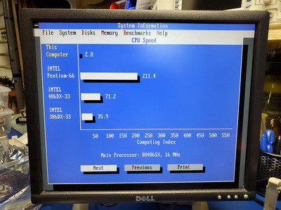

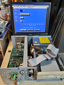

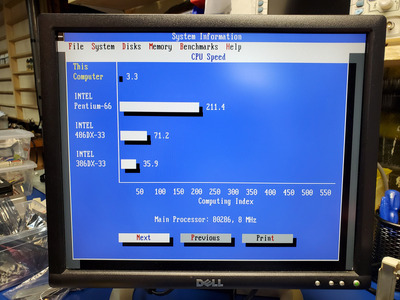

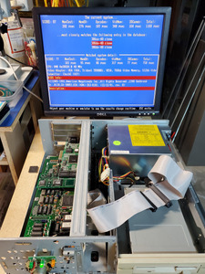

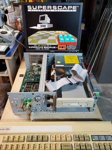

Did some testing and benchmarking of the IO Data PK-X486S50-3 (286-to-486 upgrade) in my Tandy TL today.
Weird results, using this 'upgrade' causes the Tandy TL to run slower than the stock 80286 @ 8 MHz. 😒
Without using the REVTO486.SYS driver, it runs @ 16 MHz. If I use the REVTO486.SYS driver, it runs @ 24 MHz w/ cache enabled (using /CN switch).
I also tried using the /2 and /3 multiplier switches with the REVTO486.SYS driver, but they don't seem to do anything.
In each case, the faster the MHz translates into slower reported system performance (and yes I tested multiple benchmarks and games to confirm this).
If anyone has any ideas as to what is going on, I'd love to know.

Reply 23594 of 27533, by Ozzuneoj
Shponglefan wrote on 2023-01-22, 18:29:
Ozzuneoj wrote on 2023-01-21, 03:47:
I finally took the time to get my MIDI stack hooked up. […]
That is a lovely looking stack of MIDI gear! And that Power switch unit does look cool, what brand is it?
Thanks! It took way too long for me to get it wired up and working just the way I want it to.
The power center thingy is made by National Lighting. I have posted about it in this thread:
Re: PSA: Please open and inspect your surge protectors and power centers\controllers... today.

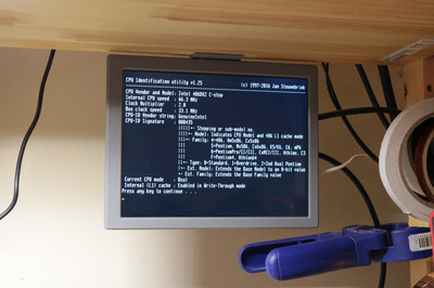

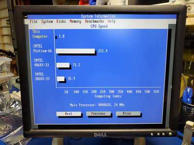

More testing of the IO Data PK-X486S50-3 board.
Tested it in a Packard Bell Legend I. Without the REVTO486.SYS driver it reports as running @ 24 MHz, but benchmarks lower than the stock 12 MHz 80286.
With the REVTO486.SYS driver loaded, it reports a speed of 48 MHz and much improved performance in benchmarking.
While this board does nothing for my Tandy, at least I have another system I can use it with.
