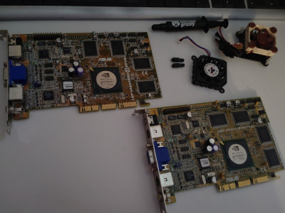

Did some maintenance and benchmarking. I ran 3DMark2001 on a V6600 and V6800 (Geforce256 SDR and DDR)
The scores were 2207 and 2638 marks on my Athlon 1000 system (slot A Thunderbird). Happy with it. 😀

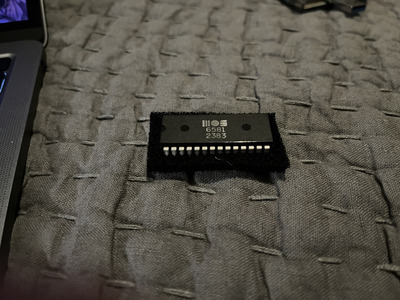

Today I switched my 6851 SID chip out with a BackSID, as the original was missing a sound channel entirely. and, now that I am looking at the chip without the rest of the system around it, it looks like it's been heat damaged in the 38 or so years it wasn't mine. the middle of the logo is a discernible shade darker than the rest of it.
The attachment IMG_1772.jpg is no longer available
But hey, outside of some songs not sounding 100% right, like demoscene stuff like 64 forever, I can't really complain.

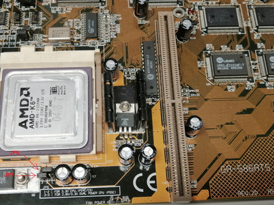

So I was talking about my GA-586ATS motherboard a few days ago and a strange thing happened to me. When I said I was testing the motherboard and she worked, I was testing it when she was still in the PC case with AT power supply it came with. Two days later when I put the motherboard out of the case, I tested it again, but she didn't post anymore. She was giving beep sounds only when the ram was removed. But when I placed a PCI VGA card, nothing. No beeps, no post screen. I didn't know what was wrong, so I put everything away until now. I tested the motherboard again but with the old power supply, I was testing it in the beginning and she posted again. Then I connected again my ATX to AT power supply I usually test this kind of motherboards with and has ATX to AT adapter and again she didn't post. So I believe that perhaps something isn't right with power supply of sending the right voltage due to ATX to AT adapter? However, it seems odd to me, because I've been using this power supply for a few years now and I don't think I encountered such an issue. I would also like to point out that AS2880 voltage regulator which has a black heatsink and is near the CPU gets extremely hot. I've measured above 60°C in just a few minutes of being connected to power and is really hot. I would like to decrease this heat somehow. Maybe installing some other less amperage demanding CPU?

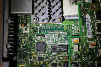

The other day I was going through some of my old boards that were put away as 'for parts', since I've found more than one board I thought was dead actually works sometime later because of a dumb thing I missed.

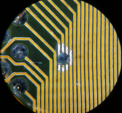

A Toshiba Satellite 110CT board that I thought had been broken when I tried to clean its corrosion, turned out to work quite well but I was using the wrong power supply which it would refuse to power from. (it needs 18.2v internal AC>DC PSU, it was mixed up with a 15.2v PSU from another model). Put it back together and found the internal keyboard / mouse were all messed up, but external kb/mouse worked. Known good laptop keyboards wouldn't work on it and it appeared that the battery leak had got to the keyboard area first. Decided to pull off the keyboard connector and found it was so badly corroded and stuck on there that in the end I just cut it up and broke chunks of it off. Some traces had gone bad:
The attachment Satellite-110ct-keyboard-tracing.jpg is no longer available

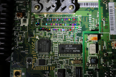

For reference, from left to right everything except the last 6 pins is the keyboard connector which integrates the upper and lower layers into one connector. Then the last 6 are the Toshiba Accupoint mouse which is a 4-way variable resistor between 5v and gnd to make up the left/right and up/down directions. The keyboard connector is mostly the same on the Toshiba Satellite T2100 to Satellite 400 / 410 / 420 / 430 series laptops.
I was able to repair most of the traces underneath and put solder mask on everything to keep it in place and not melt off:
The attachment sat110-kb.JPG is no longer available
Took a connector from a board I thought was dead (hot air 250c at full speed) and soldered it onto this 110CT. That got the keyboard working then the mouse was not detected unless an external one was plugged in. That turned out to be the Alps chip which is the internal pointer controller had gone bad. Borrowed that from the same board and now the mouse works. It got downgraded to a Satellite 110CS with a DSTN screen in the process because that's what was left and now it's a pretty nice laptop that was a pile of junk parts a little while ago.

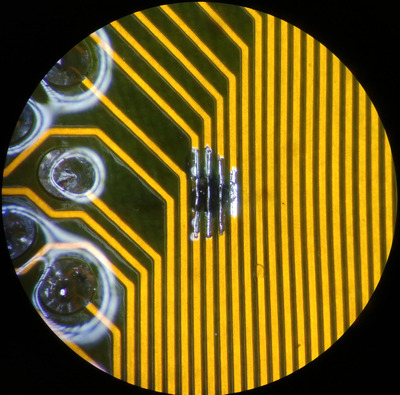

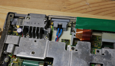

That got me thinking, I had bought a Toshiba Satellite 430 motherboard some months ago which I thought I'd killed because I put hot air on it after failing to get the VGA working right, thinking it was a badly fitted VGA card connector, I tried resoldering the QFPs and eventually it stopped posting at all after I'd worked on it a bit. I thought that maybe some internal vias were broken and these boards are fragile but no. These boards just have lots of pins and lots of things to get wrong.
Looking at it a few months later and in bright daylight I made tons of mistakes, bridged legs on some chips and the corner of one QFP had pins just completely off the board.
Delicately resoldering those and cleaning up my mistakes the board now works again and with a scrap Satellite 400CDT case, along with a mostly broken video card that can't run an LCD display, it's a working system again - til I get some better parts for it:
The attachment sat430-pcb-1.jpg is no longer available

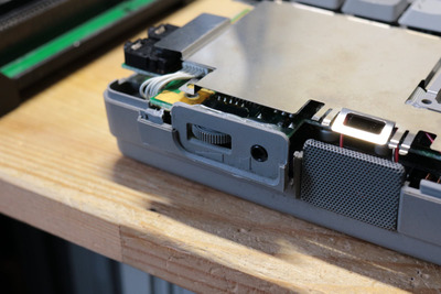

The speaker is from an HP laptop and the buttons are hot glued into place. I'm upset about the arrow keys, notice they're a different colour? Turns out melting hot glue with a hair drier also melts keyboard keys 🙁
The attachment sat430-pcb-2.jpg is no longer available

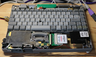

The 400CDT's case is smaller than the 430CDT so uh, I made it fit.

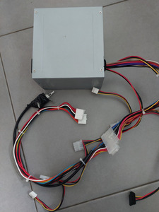

The last Satellite 4xx power supply I tried fixing had a load of corrosion in it and went bang when I last powered it, so stuff it, now the laptop runs from DC instead. This could be useful in future when more of the internal AC>DC power supplies on these 400 series laptops fail to capacitor leaks.

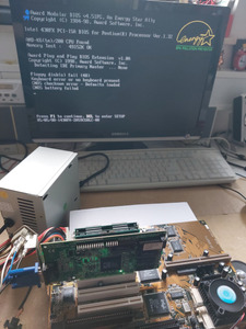

Some time ago I got for dirty cheap GA-5AX (rev. 5.2) MB, K6-2 500MHz, 128MB RAM, 20GB HDD, FDD, CD and some other stuff, but had no free case. At last my first ever SS7 PC is ready, video TNT2 Pro, audio ESS688, Maxdata case (a bit newer than the other parts, but it gets harder to find pre 2000 cases).
The attachment SS7_In.jpg is no longer available
The attachment SS7_Front.jpg is no longer available

DundyTheCroc wrote on 2023-05-14, 10:13:
Ah nice, reading Re: AGP for Super S7 with weak VRMS? and the following posts might be of interest. It's specific to the revision 5.2 of the board.
