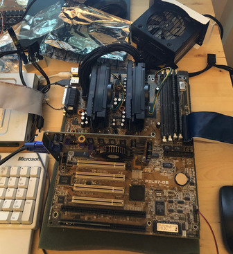

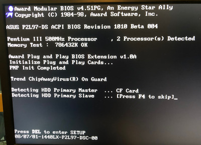

Picked up an ASUS P2L97-DS dual slot 1 mobo and have been having a time with it. I was recently messing around with a baby AT slot 1 board and discovered the joys of the 440LX chipset. Now with this dually, I think I might actually hate the LX chipset - this thing has been fighting me every step of the way. I think many of my troubles have from just not RTFM, but still.
After a BIOS update, I got it to POST with 2 x 500MHz Katmai CPUs. The board actually supports 100MHz FSB, but I was worried doing that might be overclocking the other busses so I put it back down to 66MHz to try and get it working the rest of the way. I also reduced the RAM down to supported config by the manual. Still, I have not been able to get Win2K or XP to install - crashes on "Starting up Windows" just before you config the HD. I've tried the various kernal options - MPS Multiprocessor PC, ACPI Multiprocessor PC, etc and nothing. I was able to get Win2K working with a single Celeron 333, but that's about it.
So, I'm guessing it just hates Katmais and I'm out of luck for now (don't have any other CPUs to try out).

Maybe like Athlons, it needs more juice on the +5V rail? What are the Amps and W ratings of the PSU?
1 cpu is rateed 38W x2 might suck too much? Just an idea.

ubiq wrote on 2023-05-17, 23:40:
the 440LX chipset doesn't support katmai P3s. they may function in that the voltage and multiplier is supported, but results would be unpredictable. 100MHz FSB P2 chips will work (at 66 or sometimes higher).
best option would be either celeron 300As at 75-83MHz FSB or P2 366 chips at 66MHz FSB. the onboard SCSI controller will likely stop working if the FSB is increased.

Reply 24345 of 29833, by ubiq
^^^ My understanding is that LX predates 100MHz+ FSBs, so didn't include any dividers for the other busses; anything other than 66MHz will always be overclocking on an LX.
libby wrote on 2023-05-18, 21:31:
Thanks, that was pretty much what I figured - a hard lesson in that just getting something to POST only means so much.
I don't have any SCSI devices - and from what I know I may as well stick to IDE if I'm using a CF/SD adapter; not messing around with device ids and whatever.
Anyway, I managed to find a P2B-DS that should be arriving in a week or two so this has all be good experience that will be useful when it arrives. 🙂

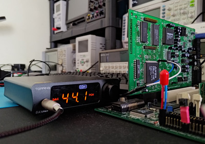

While sorting out my ISA sound capable producing digital out I realized that my CT4500 have also SPDIF contacts on PCB. So after some DuPont Connector and custom DIY RCA adapter cable fun ended up with following contraption (attached pic). Well it ended up working in DOS partially. Should have done some research first. AWE SPDIF is only 16bit/44.1khz compatible. So tracker music is N/A. Forced myself trough my FM music library (CQM yay!) . 😀
Midi is more enjoyable by EMU8000 in crisp noise free digital format. I had AWE32 back in a days so it hit my nostalgia feel a little bit.
I'm just wondering how should I set cabling out in more permanent manner. Probably via separate daughterboard...

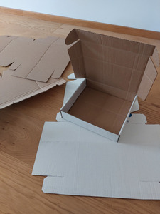

I'm making boxes for motherboards. It's really time-consuming work, but if I don't make them, no one else will.

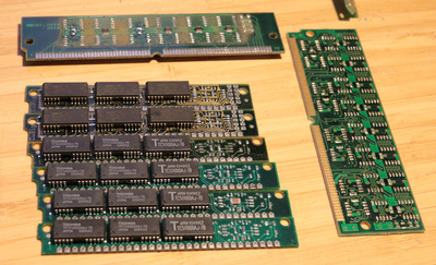

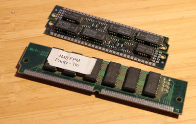

Also lately I've been running low on 1MB 30 pin simms, I even found a couple of dead ones - but I've got these stupid 256kb simms and they have extra solder pads...
The attachment ram-upgrade-1.jpg is no longer available
60ns and made in 1990? That's pretty fancy actually but 256kb sticks aren't really useful to me since I'm usually setting up 386/486 that want 32 bits and I've only got enough here for 16-bits. Even then, that's not much RAM for a 386sx either.
These ones with two sets of solder masking are wired up for either 2x 256Kx4 chips or 2x 1024Kx4 and the parity chip differs - I have two sets like this, there are these CuBig 60ns modules and a set of 4 Micron 256KB 100ns modules that are laid out pretty much the same.
My Quick 861DA hot air station got the chips off without issue at 280c with high flow rate - the chips are stored away and might even be useful for fixing video cards or older systems.
These CuBig were the second set I did where I was much happier with the process: Take off the chips from the 72-pin and 30-pin simms, put them all aside and tin up the pads with fresh solder & flux on the SIMM PCBs. Move the SMD capacitor that sits under each RAM chip to where the larger parity chip sits. One SMD cap broke while cleaning it and the 72pin donor RAM was obviously in a smoker's PC last.
Once the PCB's pads were tinned up with a bit of solder on each pad, the cheap flux was cleaned off and I put some chipquik smd no-clean tack flux on there - much nicer for hot air soldering / component placement and easily cleaned, while my cheaper fluxes leave rosin all over which tough to clean and maybe impossible once SMD chips are soldered into place.
Put the 1MB chips onto the PCB's pads which is a bit tricky since the pads are now raised. This is where solder paste would be nice but it needs a stencil or better application skills than I have. Hot aired them on at 280c again with a lower flow rate so the chips don't blow away and wait for each RAM chip to drop into place.
Then installed the SIMMs onto my test computer which was set up on a floppy to boot memtest and these CuBig modules now pass memtest on a 386dx-40 😀
This was the 2nd set, the first set I tried re-using the solder already on the pads and had to manually re-work about half the RAM chip legs to get the computer to detect / work with them. These Micron sticks also had a resistor connection A9 I think to Gnd? That was okay when they were 256KB simms but now they're 1MB the computer hates that. So I just took off the resistor:
The attachment ram-upgrade-2.jpg is no longer available
There we go, now I have 6x more 30-pin SIMMs that are somewhat more useful than before.

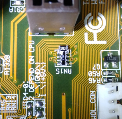

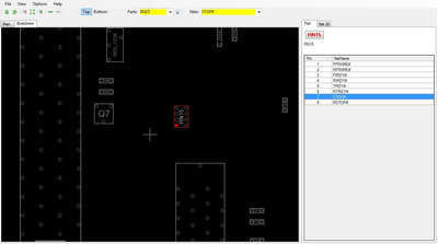

I got an Asus p3v133 board a while ago that wouldn't post and it always hang on code "0B" on the post card.
I couldn't figure it out what is wrong with it until I decided to give it another try,
this time I find a 22 ohms resistor array on top of the agp slot with broken corner and it was open,
so I soldered a 20 ohms resistor in parallel with the broken one and that fixed the issue.
The attachment RN15.jpg is no longer available
this resistor is on the stop signal between the north bridge and south bridge/pci slots.
The attachment boardview.jpg is no longer available

Where did you get the schematics?

Reply 24357 of 29833, by Nexxen
Karbist wrote on 2023-05-21, 21:12:
Nexxen wrote on 2023-05-21, 20:41:
I'm über interested in going to that place. 😀
https://vinafix.com/resources/boardview-asus- … top-tsict.1223/
Download link at top right.
Thanks mate! This is actually a goldmine!
