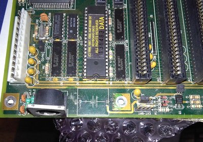

Well, I did repair a 22" Samsung monitor, which isn't really retro... and I forgot to take pics as well. Works great after a few new caps. I still need to identify the caps on a souple of SIPP-era motherboards before I swap them out.
But I also removed some corroding batteries from old 486 motherboards. Thinking about whether to put a socket for another 3.6V battery in or a header for a alkaline battery pack.
The first one was quite clean.

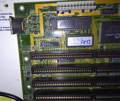

The second one was a little dodgy but not terrible.

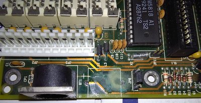

The third one, ummm...

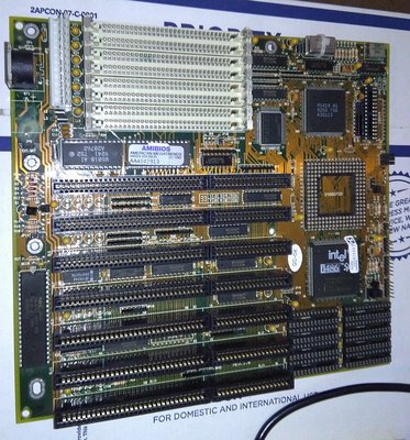

The sad thing is, that one booted fine when tested. Obviously it needs help to be trustworthy, however. It's an SX25:

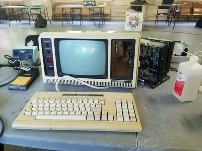

Attended a VCF workshop and got some things fixed and others diagnosed for future repairs. I successfully recapped my TRS-80 Model 4P power supply, save for a few caps I still need to order as I did not have them on hand. On the bright side, the screen no longer shrinks when the disk drives spin up!
I am still having an issue with the second disk drive struggling and reading disks slower than the first drive, though. My theory is that the belt is slipping, or the motor is set to spin a little too slowly, but I'll need to dive further into troubleshooting it before I can figure out for sure what the issue is. For now I'm just taking a regular old Teac 360K drive from a PC to use.

I like that hard drive pedestal holding up your floppy drives. Use what you have at hand. Nice looking system.
🤣 Thanks, was wondering if someone would notice. The cable Radio Shack put in there is so short that it's nearly impossible to run them out of the system. 😠
