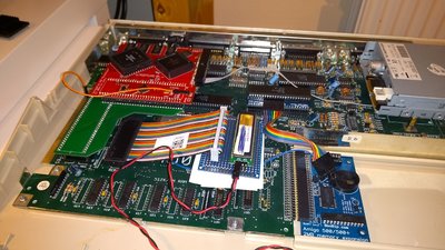

Today I began building a Kickstart relocator, because the 2-in-1 kickrom-switcher, will not fit when using the CPU relocator that I use with the TF-530 accelerator. The first relocator that I build, was too thick and the keyboard will not fit. So I soldered a second one. It is all trial and error when doing something homemade.
This is the first one that I did. Ribbon cable and because the wires were under the board, and I had to isolate it from shortening out. Wich made it too high. Anyway... I did a second more slim one after this failure.
The attachment 01.jpg is no longer available

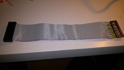

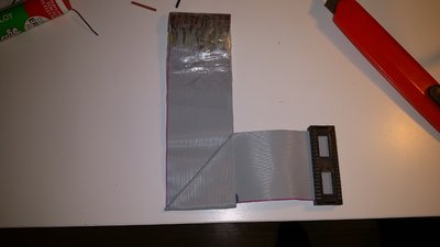

The second one, were I used an old harddrive ribbon cable and soldered it straight onto a socket's pins. Then I isolated it from shortening. It just takes a lot of time, soldering 40 wires this way.
Both relocators are not tested with a power on in the Amiga, yet a test with the multimeter on continuity, show no errors during build. Too late to test it all (it is after midnight), as I have to clean the table after all the trash. Hopefully the slim version kickrom relocator will work.

The relocators have too long ribbon cable, so there is no way they make decent contact when the machine tries to talk to them. Oh well.... Back to the drawing board. 😁

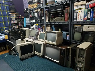

Organized my bedroom/workshop. When you have a lot of stuff and limited space knowledge of how to cram stuff is essential. 😵
My mommy said I can come over to play at your house!
Reply 10592 of 29860, by luckybob
Gotta love the John Deer curtains.

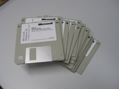

Made a safety copy of my original Windows 95 floppies, using Winimage.

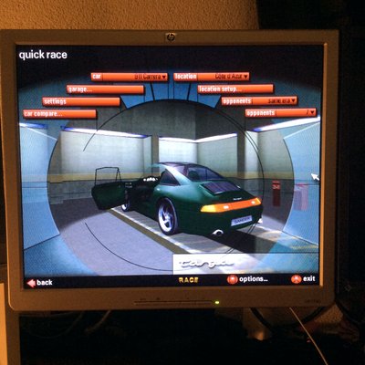

Managed to migrate save (two .HUD and one .SAV file) and game data from NFS Porsche on one pc to another pc and getting it to work right. It didn't work right at first because I got errors in the form of 'unable to open file x' with a reference to a code line, but I could force it to run ignoring the errors. It turned out that all I had to do was to unselect 'read only' in properties of the files which the game couldn't open (or write to?). Now the game seems to run error free and it saves me tons of time completing evolution mode with all cars 😀
