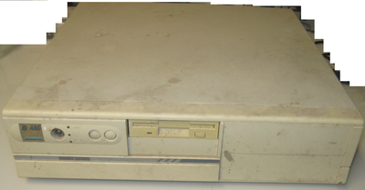

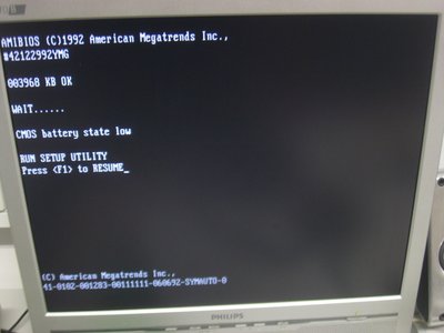

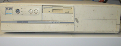

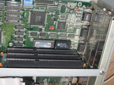

Found this sucker on some sort of a scrapyard. Already cleaned it a little bit. However the Dallas battery is dead. And here is my problem: When I go into BIOS, I enter all the data (disc parameters, etc..) and I save the settings. But when the computer restarts, it forgets everithing I've entered in the BIOS and puts me again on the first boot screen. So the computer is basically useless. Do I have to replace the dallas battery or is there any easier way out?

Reply 11422 of 27693, by Jed118
This has been my experience with most Dallas batteries. It must be replaced to continue.

Reply 11423 of 27693, by twilliamc
If the motherboard does not have jumpers/pins for an external battery, it will need fixing or replacing. There is a simple fix if you have access to a dremel and soldering iron. A quick google of the number on the chip will lead you to some instructions.

Reply 11424 of 27693, by wiretap
The proper way..
https://www.digikey.com/product-detail/en/max … 12887-ND/956874 --- Datasheet: https://pdfserv.maximintegrated.com/en/ds/DS1 … 5-DS12C887A.pdf
or
https://www.tindie.com/products/glitchwrks/gw … uct-description
Then there's always the hack-job method of cutting into the existing RTC, which I see a lot of people do but I have no idea why since newly manufactured replaced are still made for $10 each. When desoldering the old one, just install a DIP socket for easy future replacement. I found that going with a new replacement was less money than I spend for lunch at Taco Bell, so it made sense rather than wasting time dremeling an old one out.

Reply 11425 of 27693, by luckybob
Because some motherboards do not work with the replacement Dallas chips, that's why. I have a couple like that.
You are still correct in 95% of situations though.

Reply 11427 of 27693, by dionb
If your board has a DS128(8)7 I'll fully agree, but if it turns out to have a DS1387 your're screwed as they don't make replacements for those. So dremeling (or otherwise mutilating) the old RTC Ramified is the only option.
Reply 11428 of 27693, by Turbo ->
@dionb, @luckybob, @wiretap, @twilliamc, @Jed118 - thank you all for your recomandations. I will desolder the dallas chip and will install a DIP socket, that is for sure. And then I will see what will happen with modified dallas battery and what with a new one (ordered from China, that is). Will report.
Reply 11430 of 27693, by wiretap
Careful with the Chinese ones.. many people report getting them with a dead battery with a manufacture date of 10+ years ago. 😵

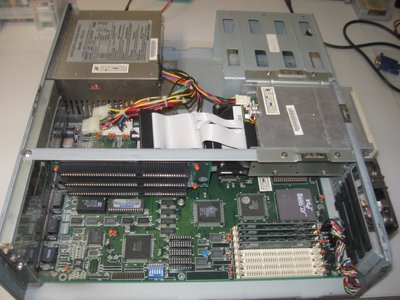

Well, it seems a bit boring but salvageable. Time to look inside:
I think it is a good starting point for a decent Windows 95/DOS PC. I think maybe I should drop in a Mach 64 a Trio64V+ or a Virge instead of the Trident 8900D maybe some sound card like a SB Vibra16 should be good too and not too long ago a coworker dumped on me a network adapter. If it works I might add it to my home network.

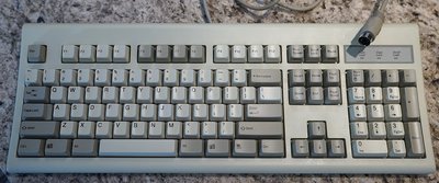

Nothing super special today, but did manage to find and cleanup an AT keyboard. Squeaky clean inside and out. Always can use an additional AT keyboard.
