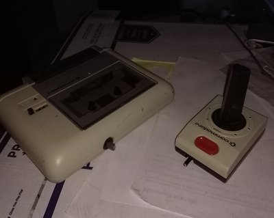

YOU SEE WHAT I HAVE TO PUT UP WITH?!?!
304.11 KiB
1130 views
Somebody did that for about 4 pennies worth of copper. Did it to the 1071, too.
Luckily they were... shall we say... not energetic enough to get into the 1541 and C64 boxes.
The monitor will probably be easiest to fix ("easiest"), the rest will be harder to find proper connectors and pinouts for - though at least it's a C64 and not a Soroc or Cromemco so parts will be easier to find.
The shortsightedness is appalling.
I did get it all cheap because it had been mangled, though. Honestly it could be a load of broken junk, but I'll bet most of it works.
Too bad they threw all their software and manuals in the trash, apparently.

I think what has happened is some clueless dingbat thinks they have cut the power cords to stop anyone being electrocuted by untested hardware.
I recently got a nice Woody Atari 2600 6 switch cheap because of that. The seller thought the power cable had been cut, but they cut the RF lead.
I'll mod the thing for svideo output anyway so couldn't care less about the RF cable.
Actually I was specifically told it was for the copper. The person who told me did that embarrassed shrug when they said it (they didn't do it).
Anyway I should be able to replace the monitor's easily enough and I might luck out of the tape drive. I bet I'm on my own with the CardKey 10-key.
Now I need to rig a way to connect the 1541 to a PC and find a bunch of my old now-long-gone C64 collection. Then once I play for a bit I'll probably sell at least the C64, assuming it all works right.

Just for the copper?
Wow, this guy would lose his mind if he saw the amount of heavy duty power cables we simply throw out every week.
