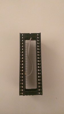

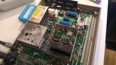

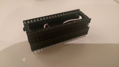

I was looking for a solution, in order to be able to use a 5 volt VIC-II chip in a 12 volt Commodore64 board. It turns out, that there are no adaptor or PCB, so I had to cook something up. Made a quick and dirty solution. No time to test, too late. I made sure that Pin-13 did not make electrical contact between the board and the top socket. Then soldered a wire between Pin-13 and Pin-40. Hopefully the solution is not too high. At least this is a prototype or what it can be called.

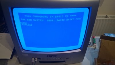

Got an VIC-II 5volt chip running in a board that delivers 12volt, using the adaptor that I hacket together yesterday.
The picture is not spot on. Still have those jailbar/vertical lines, and still have that red and green colour artifact.
Yet it is working.....

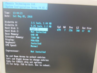

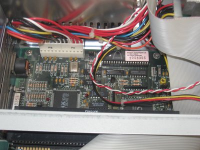

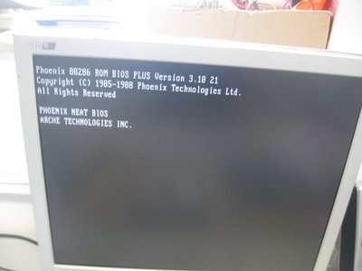

Having some hard time with Phoenix 286 BIOS. Doesn't let me enter HDD parameters, for the hard disc I have (81Mb) and it is not in the Phoenix BIOS 1-49 list. Any suggestions?

On my 286 with a Phoenix BIOS. I had a 840mb HDD running. I left the BIOS settings for the original 20mb MFM as they were, and installed a drive overlay on the new HDD. Did not make any further testing, just ran it with a standard Dos installation after the drive overlay installation. I was able to use more than 20mb of HDD space for storing games and so on. Ran overall fine. Did not feel era appropriate, so I installed an Adaptec SCSI controller and a 80mb Conner SCSI HDD instead.
