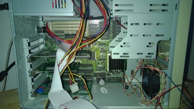

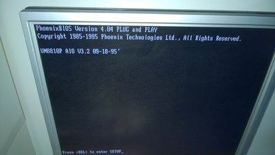

Removed the rust of this very small at-case and replaced the psu. Finally i have a space for my 5x86-133. The motherboard is a UM8810P AIO Rev 2.1.
484.16 KiB
998 views
690 KiB
998 views
438.94 KiB
998 views
Still have to decide details like the graphics- and soundcard.

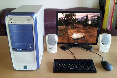

Threw this "build" together suuuuper quick to see if my office-grade Matrox G550 could run the official G400 (yep) & G200 (nope) tech demos. Basically I found this PC in the trash as-is and just stuffed in an old Thermaltake PSU, the G550, a 40GB HDD, and a fresh CR2032 battery from my stash. Done.
216.14 KiB
963 views
I didn't even rip it apart & vacuum it out, but it was already pretty clean on the inside.

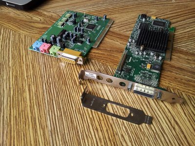

Incidentally the I/O bracket from a low-rent Sound Blaster PCI makes a perfect full-length bracket for a G550 with a DMS-59 connector:

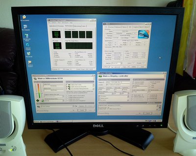

Anyway once the system was up & running I decided to throw my usual suite of benchmarks at it. The low-clocked Matrox card actually doesn't perform that bad for what it is. Unfortunately I can't figure out how to disable Vsync for 3DMark series, even though it worked fine on Final Reality & GLExcess; there's no option in the drivers & doing it in PowerStrip actually soft locks it with a black screen. But the CPU benchmarks I use got me some interesting results too.

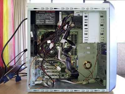

So what's inside?

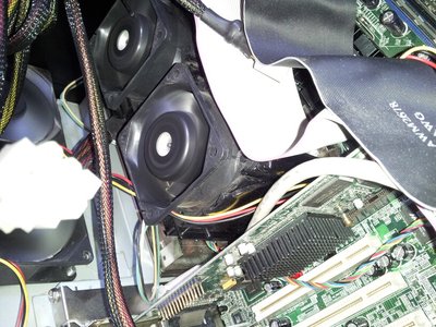

How about no cable management, no floppy bay, an ASUS PC-DL Deluxe, and four threads of Netburst awww yeah:

Surprisingly it doesn't run that hot but man is it loud. Two big case fans & two high-RPM always-on CPU coolers make a bit of a symphony. I've had one of these boards before & distinctly remember it making exactly the same noise.
So was the whole exercise worth doing? Well, the G400 tech demo runs great... but it also does on my GeForce 3 box & needed the same workaround to bypass G400 detection. The G200 demo still won't run but it turns out it's nothing special anyway (nice music though!) Oh well, at least I finally know my G550 works... two years after I bought it.

i just bought a new pc-dl deluxe. are you running xp on it?
Reply 12066 of 19656, by xjas
^^ yeah, XP SP3 with the classic theme. I would have gone for Win2K Pro but I didn't feel like digging out a floppy drive to go through the bootstrap process.

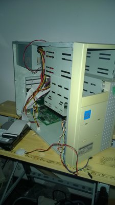

Going through my old hdds to see if they still function. 2 to around 6gig. Taken over the kitchen table. Using a P1 166 testing mobo which picks them quite nicely and has cd boot function.

One dead seagate 4gig and a faulty IDE cable so far. The latest Bigfoot has got OS/2 v3 Connect on it and appears it was setup for Netware, TCPIP, NetBuie over parallel port. Complained on startup so deleted the settings from MPTS which is used to set up networking and such.

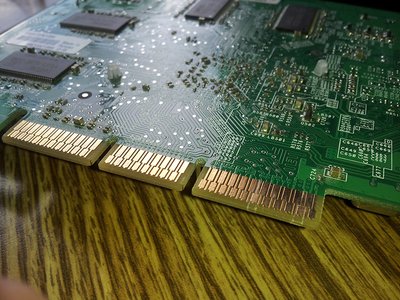

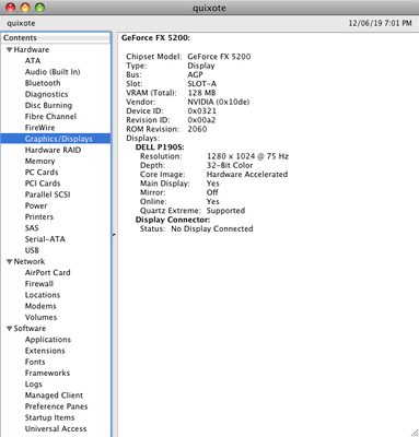

Flashed & "tape-modded" (look for it 😜 ) a Geforce 5 to work in my PowerMac G4. If you think this might be a pain in the butt to do, don't worry, it totally was!

Despite this card's miserable reputation, it's actually not a bad option for this machine. It's supported by CoreImage in hardware, which makes a huge difference swishing around the desktop in Leopard, and this is the "full" 128MB/128-bit version so it's not as awful as it could be. It runs UT2004, which is the newest game I have on the system, it has DVI, and it's passively-cooled & relatively low-power.
I think I might pull it out and cut the traces, as I doubt I'll ever need to use it in an x86 PC again. The tape mod worked as a proof of concept but doesn't sit well with me long-term.

Dude, I tape mod laptop WiFi cards (Intel AC-7260) all the time (once) to get Bluetooth working and honestly (not lying) I would just leave it and not damage the card.

I'll leave the tape mod until the next time I have to pull the GF5 out. It's working fine right now, but it's hot here and I'm worried about the adhesive turning to goo or the tape peeling off and sticking inside the AGP slot. I'd have to swap video cards back & forth if I want to run OS9 on the thing, but I haven't found a reason to do that yet.

I was just being light in that comment, but I don't recall exactly as it's been years. If you taped over pin 20 & 51 IIRC Bluetooth would work on certain laptops with that adapter. It actually worked like a charm for me, but cutting tape that small was no easy task. Plenty of info and videos out there on the subject. Not sure why some laptops worked without the tape and others did not on the AC-7260 concerning Bluetooth. You would think that would be standardized.
