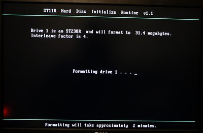

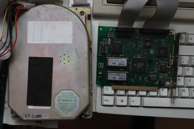

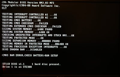

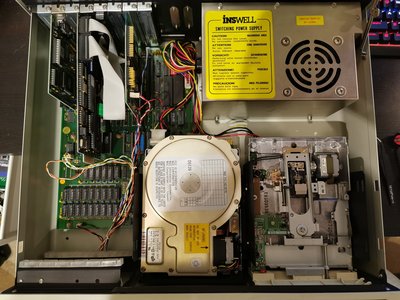

Realized that it is not possible to get this running on a MFM controller. Low-level format was possible with SSTOR, but I was not able to read any data afterwards.
So I used a Seagate ST11R 8-bit RLL controller with build-in BIOS. With the BIOS-Routine I was able to low-level format the disk with 0 bad sectors! I like that the BIOS shows me the installed disk at startup. But its incredible slow compared to a MFM-drive on a 16-bit controller...
Unfortunately I erased all data that has been on the disk potentially during my experiments on the MFM controller. Always curious to find some "lost" drivers/software on such disks. But it is unlikely anyway to read anything on a differnt controller then the one it was formatted with.

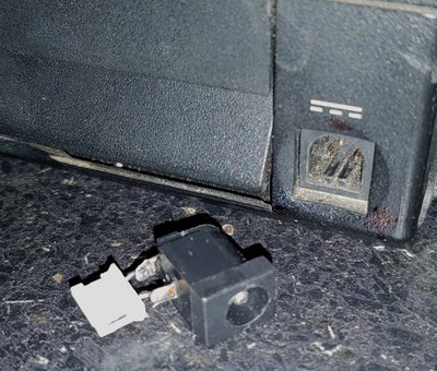

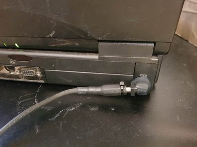

I macgyvered up a power adapter adapter for a Dell Latitude XPi laptop - it didn't fit my other Dell chargers and I didn't feel like buying a new power adapter just to test the laptop, so a connector from my parts bin and some thermoplastic makes a secure fitting adapter:

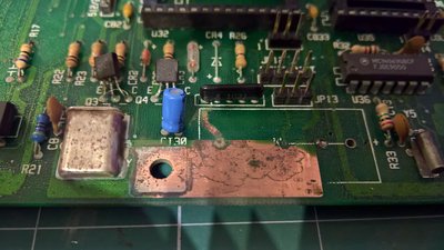

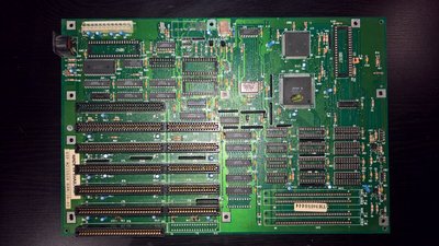

Repaired traces, replaced crystal oscillator and two transistors on an 286 motherboard, that refuses to count BIOS time.

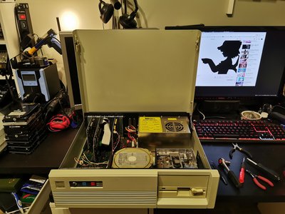

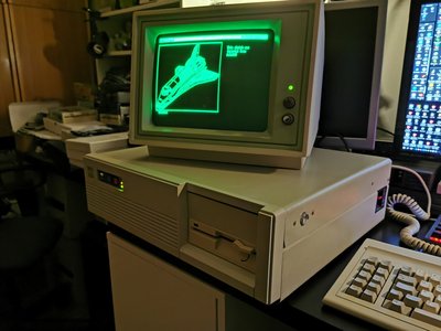

Finally cleaned up this Turbo XT machine I bought recently (after cleaning this machine is almost immaculate - certainly less dirty than my modern PC 🤣)... browsed through the HDD (it seems between 90 and 94 it belonged to some PhD lady from Warsaw University of Technology - a lot of scientific stuff and her projects) and paired it with recently purchased monitor...

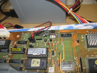

Oh! I have very similar motherboard an simiral problems, but in my case - it counts time too quickly (like skips 2-3 seconds instead of 1)... Similar dammage too... I replaced ceramic caps which were cracked, but it didn't helped... which oscillator you replaced?

Reply 13311 of 19656, by Turbo ->
14.31818MHZ - usually 286 motherboards had oscillators with such frequency.

Turbo -> wrote:
Agree, the smaller oval shaped xtals back then were the 14.31mhz ones. And your Turbo XT looks great !
