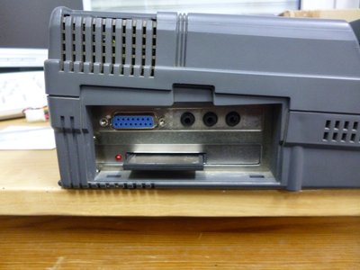

Reply 13589 of 27539, by OldCat
Tiido wrote:
Yesterday I recapped the floppy drive of my T3200 and now the drive works once more ~
I could copy out the stuff it had on it and later I'll prep it for installation of new DOS and games etc. I have already installed a sound card and a LAN card, mTCP will be put to use on that thing since floppies are inconvenient 🤣
Ooh, I missed it: do you have Toshiba T3200 (or T3200SX)? If so - welcome to the amber glow club, my friend. 😎
I have sound card and SD card instead of HDD in my T3200SX, and just SD in T3100 and T5100 (fewer slots). I would love to also get T5200 and T3200, but alas, not enough money for that recently.
