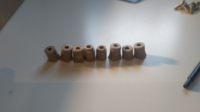

The screwholes for mounting the keyboard inside my C64 case were worn out. So I cut off some of the plastic, and glued in some brass standoff's, using epoxy glue and covering the both the plastic and the brass standoff's with some more epoxy glue. Now I have to wait at least 24 hours, before I can begin to re-assemble my Breadbin.

Aaaah! Nice! I've had numerous VIC-20s' plastic mounting poles turn to dust so this is an interesting solution.

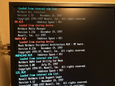

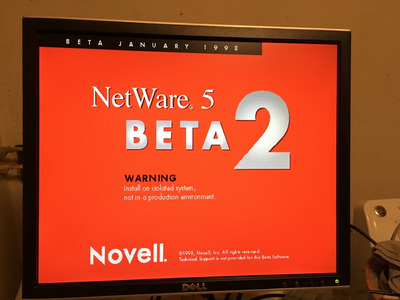

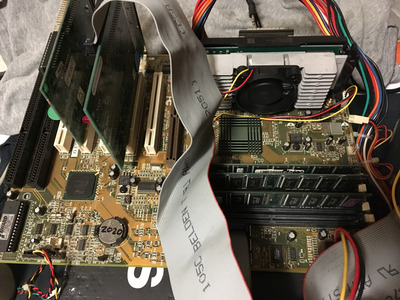

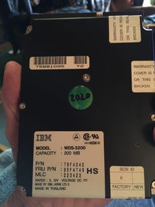

Fixed a Soyo SY-6BA motherboard today, was having issues. Then went on to test some older SCSI HD's and found one in the stack with NW5 beta from 1997. Drive works great and thought would share some pics. At one time in late 90's we ran Netware but thought all the old drives were long gone. Flash from the past: IBM WDS-3200 200Mb scsi drive:

I have done the three ones in advance, that are those you that holds the case together. When the epoxy are hardened, i will use the plastic that I cut off, to make a thick plastic cement. For that I will dissolve the plastic in a tiny bit of acetone. Then coat the standoffs with it, to strenghten it even further.
