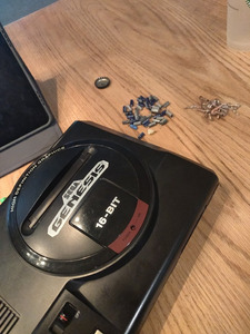

In the quest to figure out why my Genesis is totally fine with the Sega CD but hates the 32x, I went and eliminated at least one of the potential causes. My genesis has been completely re-capped now, and it seems happy to finally be rid of the ones that predate my parents getting married.
148.98 KiB
1413 views
Of course, the issues I was having have persisted, so I guess things are gonna get even more interesting soon enough.

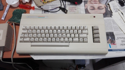

FInished restoring my breadbin/Aldi styled c64g , picked looong ago at a Flea Market for just 10 eur.
Usual Black screen.

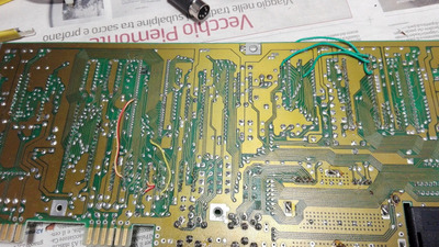

For the first time i had some issues with my Chinesium desoldering gun 🙁 used a bigger tip to try desoldering the stubborn pins and made a mess with some traces.
I am a bit disappointed. Maybe it's time to buy a Hakko.
598.97 KiB
1329 views
Repaired all traces 🙁
I've socketed all chips excluding the superPLA since i did not have any spares of that.(the bigger chip you see in pic)
Tested all ICs:
One of two CIA,both ram,both ROM, and SID were broken. I suspect the previous owner had a faulty power supply at 5v maybe? Too many chips broken (they are from'88, so they should be more reliable than the '84 batch)

Had spare parts for everything except for one ROM (flashed a spare 128k EPROM and it works without adapters,it's the one covered with red tape), and it works again! Thankfully the superPLA chip is still ok.
Retrobrited all keys and the lower chassis.

Great work! I'm not a soldering guru but have had some trouble with C64's in the past too - they have such chunky circuit boards that parts of them act like heat sinks I've found, so all your heat disperses into the board and the bloody solder around the pin won't budge.
Anyway a little trace patch wire adds character, nice work bringing it back to life.

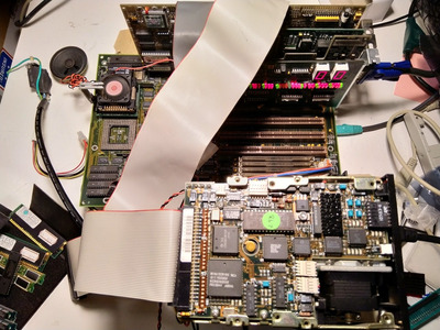

Iiiitsss aliiiive! (more or less)
How's this for a Frankenstein:
335.11 KiB
1260 views
ECS SL486E EISA / ECS Local Bus motherboard
BusTek BT-747 SCSI/floppy controller
SMC Ether 10/100 NIC
Compaq Advanced VGA
Am5x86 on VRM interposer
4MB FP
Miniscribe 8425S (yes, ancient 21MB 1987-era drive)
This is a build I've been messing around with for literally years. Every damned connector on it was oxidized, so electrical connections were flaky on everything from cards to CPU. The SIMM slots are incorrectly numbered, first bank needs to be filled first, but that's slots 5-6-7-8... however the biggest issue was of course the soldered DS1387. As it's the 1387. I made a bit of a butcher's job of de-soldering it, losing a few pins in the process (damned GND plane soaking all my heat as usual) so after putting in a socket I needed to bodge a prosthetic set of legs onto the module using another socket. Then hacked it open to connect the external battery... it wasn't pretty but it worked. About twice 😦
Because of all the contact issues I wasn't sure the problems were related to the DS1387 - if removed the board definitely didn't even start POST. So ordered a new one and installed it today. Not only did the system boot, it turns out the 21-year old battery still holds power. So I'm back in business.
EISA config was interesting. Little things like the FDD on the BusTek card was disabled by default and the Advanced VGA card claiming it couldn't do any graphical modes (it can, I checked afterwards). The HDD is temporary of course, it's the only 50p SE-SCSI drive I had at hand. I have a huge 535MB full-height 5.25" drive I could use, but it's currently doing cosmetic duty filling a bay in an XT clone, and it's so noisy I don't want to use it anyway. Only alternative I have that's not far too big (or fast - 486 running a Cheetah 10k.7 is even more crazy than an old SCSI-1 20MB drive) is a 1.2GB Seagate ST31200WC pulled from a Sun Sparcstation. Only it's worse than the monster drive, this is the loudest single drive I have ever had. Oh well, once I run out of 20MB I'll choose (or buy) something.
One issue I still need to sort out: keyboard. The keyboard seems to go crazy (registering huge numbers of presses) at random and at pretty much every boot. Press a key and it behaves again for a while. Feels like de-bouncing is also off. Tried three keyboards: same trouble. Tried a different keyboard controller chip: same trouble. Downgraded to 486DX33: same trouble. Weird...

Must be the keyboard port itself.

Given the oxidation I'd be tempted to believe that, but I have my doubts. It looks like the spurious keypresses are coming out of some buffer. Last example: I had previously entered "c:". Then realized I needed to be on floppy after all. I pressed "a" and got "ac". Backspace removed the "c", but then when I pressed ":" I got "a::" as if the next character also recalled the next one being stored somewhere. And no, no DOSKEY or similar installed. Completely vanilla MSDOS 6.22 install. For that matter, the same thing happens in BIOS, so it's OS-independent. Of course, as I'm typing this it seems to have stopped misbehaving. For now.

Nice ! Got to love EISA 😁
Ugh ! Hate KB errors/issues. Maybe a partly dry cap and it could end up working OK after having power on for a while. Have seen some odd behavior on old boards stored for a while that smooths out after powered up for a hour or overnite. I have a KB error on soc5 that I can not figure out. No visible corrosion, all traces good, volts good, diodes good. Hoping it is not the via 82c416 chip........
