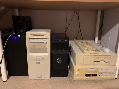

So this lockdown and furlough in my country means I have had plenty of time to crack on with some of my projects.
Finally have all of these systems set up just as I like. Only 2 will remain here for use.(I also have 2 different compaq deskpro in storage!)
MESH PC:
1GHZ Athlon
Asus A7V
512mb ram
Geforce 3 ti 200
Soundblaster LIVE CT4780
16gb CF Drive.
Windows 98se
Cheap black case:
Pentium 3 600mhz
Gigabyte GA-BX2000+(Returned from the dead after a bath in IPA!)
256mb ram
Geforce 2 mx400
Creative Vibra 16s CT2890
40GB HDD
Windows98se
Top Desktop:
486sx50 with 256k cache.
Trigem motherboard with integrated I/O.
16mb ram
Trident 8900C 1MB VGA card.
Soundblaster 2.0
200mb HDD
Dos only.
Bottom Desktop:
Pentium 133 Mhz
Biostar M5ATA Motherboard
32mb ram
ATI 3D Rage II
Yamaha MF-719 (OPL3 and GM chip onboard)
1GB CF Drive
Windows 98se (Was going to be 95 but 98 retains almost all compatibility that I need and just makes things easier.)
The pentium was meant to be a faithfull recreation of my own 486dx4 from my childhood but I was having issues with it as well as performance issues and ended up going through the 486 board and 3 other socket 7 boards before settling on this one.(Mainly because it was the only one fully working!) The DVD/CD-ROM drives are placeholders as I do not have a spare bezel. The CDROM drive is broken and I do not want a DVD drive spoiling the look that I want.
After working on that bottom one for over 1 week and getting frustrated it was very satisfying to polish off all of these builds in one day!

I like the look of this one ! Great work ! An SX50 ? 🤣 maybe upgrade it to a DX66 ?

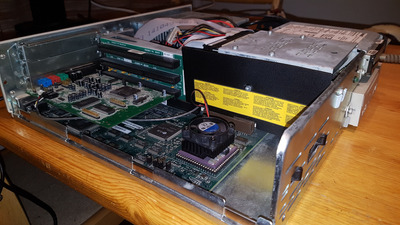

I did bit of upgrading for my compaq prolinea 4/50S.
I replaced 486sx2 50Mhz cpu with intel overdrive 486 100Mhz cpu, but I noticed it was running bit too hot with just the standard heatsink so I installed a small fan on top of it.
I replaced original Seagate ST3391A 340Mb hard drive with Seagate ST33221A 3.2Gb hard drive to get bit more space.
I installed Mitsumi 8x cd-rom drive that helps with file transfers to the pc.
I installed Sound Blaster AWE64 CT4520 to get sound in dos games.
I think it is a pretty good system and I expect the motherboard last quite long time because it doesn't have any electrolytic capacitors.
Only minor thing is that I have not been able to find a cache module for this motherboard and because of that it is about 10-15% slower than a real 100Mhz 486. If I had that the system would be perfect.
If anyone has any ideas of how I would be able to find one of those cache modules, I would appreciate it.

I did start a thread on what the best CPU for that machine would be as I wanted to max it out. In the meantime however I got a hold of the other desktop system with a dx4 in it so the original 486sx50 system became a side project rather than something I will actively use 😀
I will still stick a dx66 in should I snatch one cheaply enough 😀

May I suggest some dust-removal on that poor AWE card? 😉
What kind of cache module is needed for it?
I did ask about it in another thread and I think the best reply I got was Re: Compaq cache module compatibility.
It seems it would be 197005-001 if the answer is correct. Of course if 256Kb one would exist, it would be better.

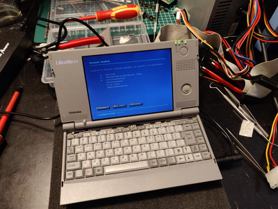

I got this very clean Libretto a while back. Unfortunately, it would not power up at all.
When opening her up I found a lot of acid damage from the CMOS battery (d*mnit, what a waste). I also snapped of the flimsy plastic screen connector retainer during disassembly, even though I was really careful. Sucks!
I bridged some damaged traces but still no life.
After measuring some of the fuses I found one with no continuity. Since I was in a 'screw it' mood by then I bridged it with a wire and tried it.
1.5 MiB
253 views
Seems to work just fine now. I should replace the fuse though, and the harddisk sounds like it's dying, itshould be easy to replace with a CompactFlash.
Now to find a way to fixate the screen connector...
