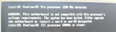

Today working from home as usual, got kicked out of home office for a conf call, so had to do mine from the retro den. And if I was there anyway, I might as well do something with it. Turns out (surprise, surprise) my SE440BX-3 doesn't take too kindly to a Tualatin Celeron 1400A:
58.01 KiB
312 views
(fortunately my product manager is as much a geek as I am, he loved watching me at it, while the project manager we were both dealing with was shaking his head at the kind of people he had to work with 😜 )
Also confirmed an Oak Technologies ISA card was working fine, as was a Celeron 466. That means I now have two matched pairs for my BP6, but with 533MHz and 466MHz neither is exactly overclocking material. Need to find some C300A/333A for that.
