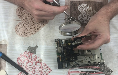

But I could not let this Quadra without a working floppy disk drive, and then I did repair it
Here is the floppy disk drive:
96.54 KiB
593 views
The drive would not let me insert floppy disk in so I started to disassemble it because there was an obvious mechanical problem:
83.18 KiB
593 views
Once the top part was removed, I could confirm something was wrong in this because the disk could not be inserted:
80.07 KiB
593 views
And I finally found it was not working due to old grease dry which made the system block the retention mechanism.
After a big cleanup, I could insert floppy disks:
87.64 KiB
593 views

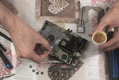

Reply 14921 of 19656, by Rodrik
Then I did disassemble the bottom part too to do the same cleaning and add new grease:
94.95 KiB
593 views

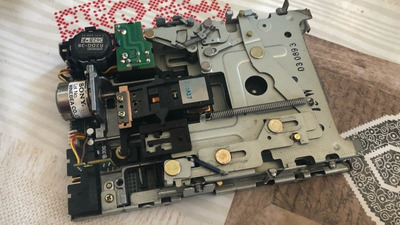

Then I did cleanup the heads with Acetone and Isopropyl alcohol. But I also took a look à the eject motor stuck in a bad position:
96.28 KiB
593 views
No missing tooth on gears.
So I assembled the drive back and made a test, and it did read the floppy disk on the first attempt:
97.7 KiB
593 views

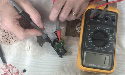

But the drive would not eject the floppy disk when asked 🙁
So I took the drive out once again and took a look at the eject mechanism again and found the contact was not working:
80.7 KiB
593 views
I spent quite a lot of time fixing this but when I reassembled the floppy disk drive, if would not work better, if was reading fine but not ejecting.
In fact, the motor had no reaction at all. Then I did cleanup the eject mechanism of another very rusty drive to swap them out.

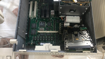

Finally I had a working drive ejecting floppy disk properly when I throw them in the trashcan:
61.91 KiB
593 views
And this last fix granted me with a fully working Quadra 700 (except the missing buttons).

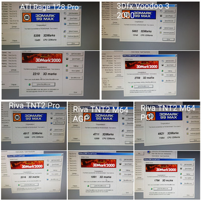

Typical. TNT2 series even the strongest one usually manage 286 texels per second and that's Pro. Low end Geforce2 starts at 350 and up on other models of Geforce2 series.
Still, I'm curious about what need for TNT2 even Pro for what? I'm talking about how much of games that is not speed sensitive on a PII or PIII with TNT2 AGP card? How compatible with Geforce2? Even Geforce4 MX440?
I'm referring to late DOS games
Cheers,
Great Northern aka Canada.
Reply 14928 of 19656, by appiah4
Hell yeah the Rage 128 Pro is a kickass card.
I wish you could test the Rage 128 (non-Pro) and regular TNT.
The TNT2 M64 is a secret retrogaming hero too.
