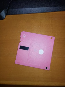

Me again, it goes on.
Another 40gb gave no joy, so i thought about th bios. Ahh, not the newes, maybe withg the newest i would have luck. So started my 386 to make a bootdisk to flash for future....
Error no disk or whatever. Pulling out the disk i gotz this:

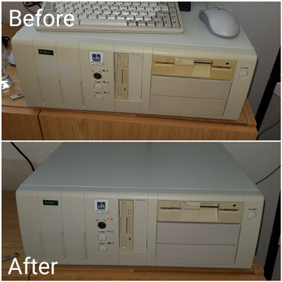

'twas a sunny morning today, so I decided to give the 286 a peroxide treatment until the clouds rolled in, I should give it another try soon

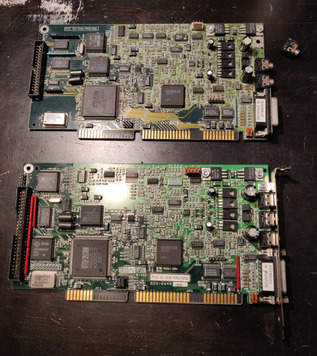

Cleaned these two PAS cards I got in a scrap lot long ago. De top one is missing the bracket and had a damaged Line In connector. Ordered 10 replacements for $0.99 on an auction site.

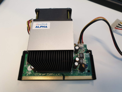

Had some time today to check a few Slot 1 and Socket 370 CPUs that I thought were dead... a Pentium II 400, a Pentium III 650, a Coppermine Pentium III on an ASUS S370-DL Slotket and a Celeron 1.4GHz on a Powerleap PL-iP3/T.
I tested them all on a Chaintech 6SSA2 mainboard that I had lying around and had not been used in years. First I tried the Pentium III on the adapter, which was the one I suspected still worked. After a minor issue with the graphics card and RAM, the system booted, albeit with the wrong bus speed. This was easily changed in the BIOS though. Suspect number 1, a 1.0GHz P3, was working!
After that, I tried the 650MHz P3. That booted right away, even though the bus speed was off again.
Then the 400MHz P2. What do you know? Also worked!
With a 100% score so far, I thought I'd also give the CPU on the Powerleap adapter a try. I was certain that would not work, as I tried it several times before. I removed the cooler from the CPU first and then the cartridge frame from the adapter. There was no visible damage. I removed and reseated the jumpers and set the jumper for a 66MHz bus speed (although the CPU is for 100MHz). Cleaned the contacts of the edge connector and put the cooler back on. I did not yet reattach the cartridge frame, but put in the CPU slot on the mainboard, using a bit of support to keep the CPU from tipping under the weight of the Alpha PEP66T cooler. And guess what? This one also worked! The system reported a CPU speed of 924MHz, which was correct (14*66). Changing the jumper on the Powerleap adapter did not make a difference in clock speed, but changing the FSB in the BIOS to 100MHz made the system work at the correct speed.
All in all, not bad for a bunch of CPUs that were all suspect! A few of them may find a way into my retro systems at some point.
