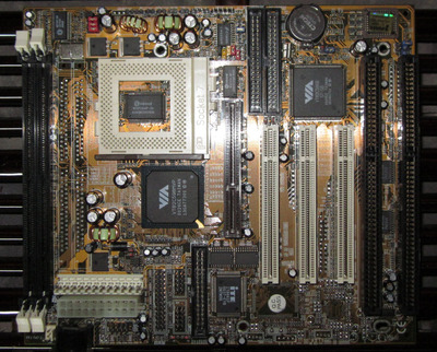

Reply 16042 of 27716, by amadeus777999
Took out an old, rarely used Super Socket 7 board and put a K6-III 400 onto it. I ran the cpu at 133x4 mhz with the 2nd level board cache disabled... that thing roared.
-172fps in Doom timedemo 3
-56fps in PCPlayerBench in 640x480
-super smooth in Blood at 640x480
tool used was K6WC(parameters: e4000000 and 16)

Reply 16055 of 27716, by amadeus777999
chrismeyer6 wrote on 2020-06-26, 11:36:
Nice. Which SS7 board did you use?
It was a PCPartner MVP3BS7-954... given I got the model correct.
