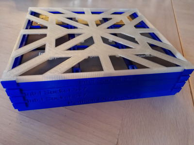

All though learning to draw 3D constructions might not sound very retro'ish, I think it counts anyways, as I have been drawing trays for my CPUs. Very much inspired by Matze79's design, but drawn all the way from scratch using Fusion360 which is free for non-commercial use (at least for the first year, it seems).
So, stackable 180x160 mm CPU trays and a lid. I plan to share .stl files when I am satisfied with the design 😉
Should of course be printed in ESD safe material - I didn't but let's not discuss that 😉

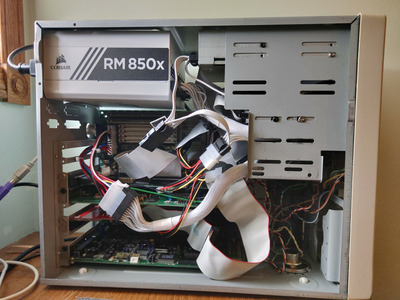

Finally got everything setup...
1.62 MiB
1084 views
Yeah it's kinda more nasty in there then it looks. And I still got a 5.25 floppy drive to add!
The board allmost didn't fit too. Had to gently push under against the HD cage. Might have scuffed the side of the movie a bit but atleast it's in place 🙁
It's a DataExpert EXP4044 for those curious.
Well. Now this just furthers my desire to pickup another 486 board! But atleast for now, the build is done.

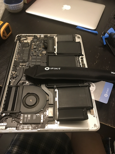

433.25 KiB
1042 views
Battery Swap
b) Replaced the battery on my 2014 MacBook Pro Retina. Those batteries are glued in and required a hot goo bag and a plastic card to scrape it off. *ugh* I do not want to go through it again.

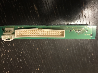

741.51 KiB
1042 views
Stupid bent pins
Pretty damned poor. Had to slowly and carefully unbend those pins. However , this does lead to:

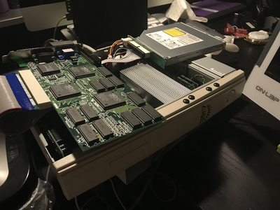

765.42 KiB
1042 views
Works but ugly
The DVD burner now works with the Igel-J. It's a slimline laptop model and the 40 pin IDE to 50 Pin JAE adapter was needed. I had to pull pin 28 on the IDE cable to make it cable-select (since otherwise both the IDE44-to-SD adapter and the optical disk will both grab primary on the IDE channel). The question now is...how to make it fit. My guess is that once the CPU shows up (the K6-2+ ATZ was never shipped (and refunded), and I ordered a K6-2+ ACZ instead), it'll get the active cooling fan, the passive heatsink block will be pulled out, and I'll have to mount a Gotek and a DVD Burner in that general area. Oh, and I am missing a CD audio cable.

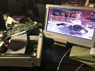

807.28 KiB
1042 views
Q3A Time
Oh well. One at a time => Q3A time.

Nice ! Think you are wasting that 850 psu on a 486 build. Would be better for a P4... just my opinion ;p

No way ! Some heavy cornered box must have been dropped on it but gut says: That adapter and box was probably bent before shipping.
