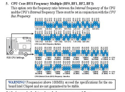

Later revisions of the ASUS P2B could als be set at fsb frequencies up to 150 MHz via jumpers. Like for example revision 1.10:

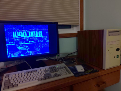

I know Woodgrain 486s are probably a dead fad at this point, but I couldn't help myself.
I got my VLB IDE card to finally play nice. Apperently it doesn't like the second IDE channel even so much as being touched. So I hooked the CD up to my soundcard instead.
a 16mb ram and 5/4 floppy disk drive update are on the way. But otherwise this DX4 build is pretty much done ^^

LGR approves of the Woodgrain 486. Got my Socket 7 system up to speed by adding the aweutil /s at the end of the games.bat file when the exit key or after the game is done to reset the AWE32 music sound font.
