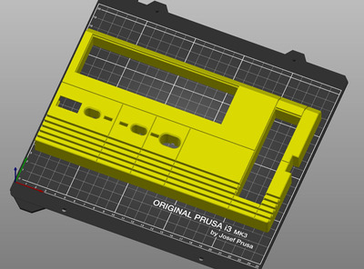

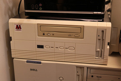

It's do-able, just it'll need to be multiple parts that all fit together. Ideally with some steel or aluminium bar giving some rigidity to the object. I've been pondering it for a while but not getting very far with it yet. Having a surface large enough to work as a side panel is rather tough with the size limit of the Prusa i3, which is slightly smaller than a sheet of A4 paper in total print area.
I made this bezel a while back, it prints in two parts and slots / glues together - this should give you a good idea of the scale of a PC compared to a 3d printer's print bed. This is a small Micro ATX case (Yeong Yang A210) and it still had to be printed in two parts. Getting such a big and complex print to stick for all 8 hours of print time was tough as well.
I should really put some time into wiring up the 'turbo' display for this thing at some point 😀 It's got a 386DX40 in there
