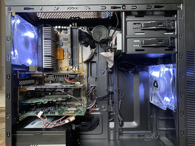

I decided to manage the cables in my main retro system earlier today, now that I have an AG430HX on the way. Might as well make sure I have the room for a semi-modular setup.
1.75 MiB
672 views
I eliminated an extra PATA cable, managed to use the power cables for the GOTEK and IDE-SD combo I have in the top drive slot to keep the floppy cable out of the way, and managed to pull cables together in a way that didn't try to bugle the back of the case out. I know my combo cable for the CD audio looks nasty, but it'll be useful when I have the Yamaha and AWE64 running side by side.
