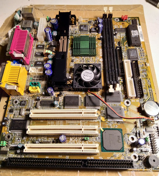

Soldering time today - I recently found a third MSI MS-6168 i440BX with onboard Voodoo3-2000 8MB.
First one ran everything up to Tualatin but had bad video RAM. Second rock solid but despite being exact same revision with exact same BIOS (I swapped EEPROMS) and exact same VRM circuitry, it utterly refused to boot with Coppermine, let alone Tualatin. This new one came with Coppermine, and no artifacts, at least not in BIOS screens, but before I could see that it needed some work: had to replace nine caps:
1.65 MiB
3065 views
Mission accomplished. Nice somewhat shiny but completely flat and functioning Panasonic caps installed. Tomorrow I see if the CMOS battery still holds a charge, then I see what happens if I hook up the SSD with Win2k I used with the other two...

Good work ! With no AGP slot can see why fixing it is the only alternative 🙁

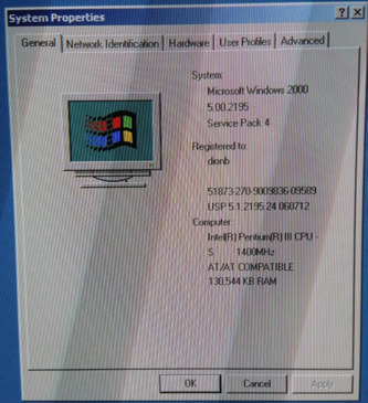

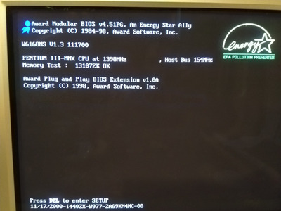

Yeehaw!
MS-6168 running with P3-1400S

Unfortunately UT gave me a BSOD soon after I actually started playing, so 1400MHz (and it's power draw) and/or 133MHz on an uATX, highly integrated BX board seems too much. Will play around with voltages to see if I can solve that.
Edit:
It's the power draw. System is rock-solid with P3-600E overclocked to 800MHz, so 133MHz FSB, but crashes almost as quickly with Tualeron 1200 as with the P3-1400S. Looks like Tualatin is no-go unless I can power the CPU with a separate VRM or something - which I don't have :'(
No surprise really with a 1999-era BX board built with cost reduction, not top performance, in mind. Tomorrow will check with P3-1000EB, see what that does.

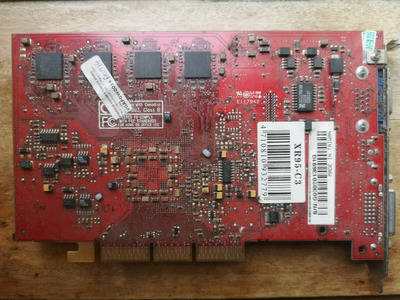

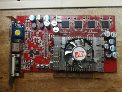

Finished refurbishing Radeon 9500 card that I won on eBay auction for 10€.
Before pics:

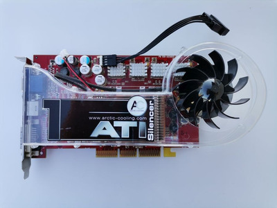

After cleanup and with new cooler and memory heatsinks:

Got lucky on R300 silicon lottery with this one. All 8 pipelines are functional with modded driver, and GPU clocks just shy of 400MHz 😁.

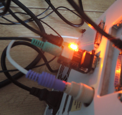

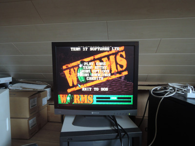

Testing new PS/2 mouse to serial converter PCB with Worms 😀

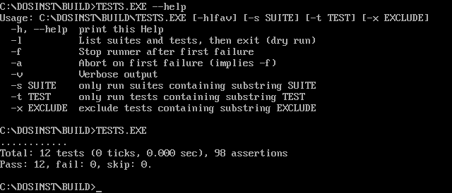

I finished it too close to bed to mention it on the same day, but yesterday's retro activity was completing a very delayed blog post reviewing unit test frameworks that are easy to use and can build into real-mode DOS executables using Open Watcom C/C++ 1.9.
Here's a screenshot of what my recommended choice (greatest) looks like when running in DOSBox.

The post also has plans and research (but no tooling yet) for doing functional testing on DOS stuff. (TL;DR: Give the program to be tested a serial console and write your functional tests on another machine, such as the host DOSBox is running on.)
