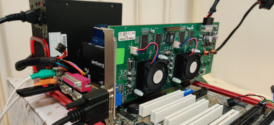

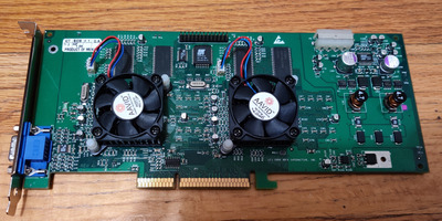

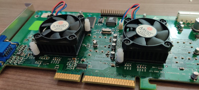

Reply 17231 of 27717, by Aublak
I finished repairing a broken Voodoo5 today. I rescued it from getting turned into scrap.
See here. Re: Bought these (retro) hardware today
Theres another one that I found, but I'm not sure if I can repair it. There's some broken traces and I don't trust myself to not screw up. I may end up selling it. Maybe someone can get her humming.

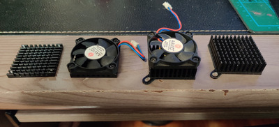

I found both cards with no slot cover or heatsinks. I found similar Aavid fan/heatsinks online, but I wasn't satisfied with the heatsinks so I modified some typical chipset heatsinks instead. I feel that keeping the original fans maintains its authentic look. As for the slot cover, I found a replacement at the e-waste place I go to. Its not the original one but its close enough 😒. It sits a little too high, but I'm sure it'll do its job.
It completed the default 3Dmark2000 benchmark, but I wasn't really impressed with the score. Its not that far ahead of my Voodoo3 3000. Might be the cost of 32-bit color or 3Dmark2000 just not utilizing the 2nd chip? I use a Pentium II 450mhz on my testbench, maybe that might be holding it back?
Anyways, I'm the proud owner of a Voodoo5 now.

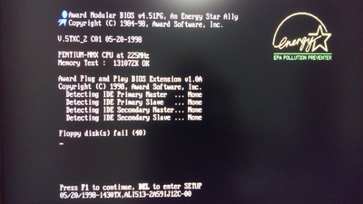

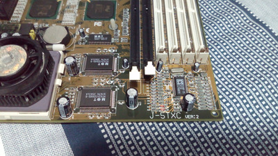

Got a Jetway (J-Mark) 5TXC rev 2 from Ebay as not working for $30 AUD delivered including Pentium 200 MMX CPU.
A real bargain, has Intel TX chipset and support for 83mhz bus speeds and up to 4.5x multi.
Anyway it was dead, no post at all. I pulled the Bios chip and noticed pins 15 and 16 were corroded. Cleaned up the
socket pins as best as possible and cleaned the Chip pins with sandpaper, loaded the latest bios (in my eprom programmer) that I got from
the J-mark website in the Web archive and Walla! all working now.
