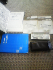

Fired up the SHARP PC-1500 from 1983. Haven't fired it up in six or so years. Absolutely no problems at all. Has nice ali front too.
Even back then portable computers had battery power saving features. Believe it or not....

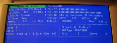

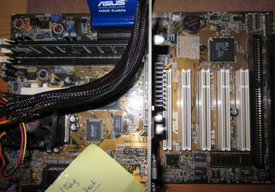

"Revived" old ASUS P5A with a new BIOS (1007.bin) - diagnose card was showing 0xffff but no picture so I assumed it must be the BIOS since it was the last step in the procedure.
Happy news aside the board's cache is nonetheless smoked but I'll use it without and instead up the fsb. Good enough for a 586 era test board.
