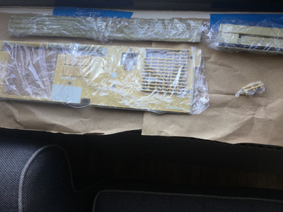

What method do you use? I use the hair bleach cream, saran wrap + sun. You gotta get it on there somewhat evenly and apply the wrap tight around it and not let bubbles appear. I've never had a bad turnout, only one was "fair" (still better than the yellowed color it started with) because I didn't apply the wrap properly and I put it in front of a dirty window, so when the sun moved, the dirt eclipsed certain parts of the computer. The solution was to do it again, outside, with an even coat. It markedly decreased the blotching, at first glance it looked great, but some spots were still a bit darker than others. I wouldn't call this marbling per-se.
Other than that, I'm down to 30-40% of the bottle, which I bought probably 2, maybe 3 years ago. Investment has paid off though 😉
Yea this was my first time retrobrighting and I used that same method. Everything I read said it takes at least a day in full sun, so I did it in the morning, left it on the windowsill, and went out for the day. Probably not a good decision for the gray trim which was way overbleached. Also dealing with saran wrap is a PITA and i think that partially causes the unevenness, especially if it's not perfectly set up. The 40-cream application was very smooth, I used a foam brush. Clearly there was a different impact on the gray trim, those parts definitely came out with more problems than the beige.

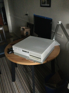

Heres some pics. The one with Diablo on the screen shows how bad the front trim's marbling was. I ended up fixing this by sanding with progressively finer sandpaper. Lost a bit of the texture but looks 100% better than before.
Still need to find a beige floppy drive 🤣.

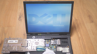

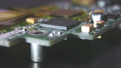

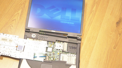

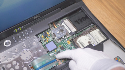

In a moment I will be reballing one of the memory chips of mobile Radeon 9000 card. I bought a spare one for one of my Dell Inspiron laptops (8100 or 8200). It was described as defective, because it generates artifacts, but that didn't discourage me.
I had exact the same problem with another Radeon 9000 5 years ago. Artifacts disappeared when touching exact the same spot on the video card. After reballing it never had this problem again. I guess that there is excessive mechanical pressure in that spot, which deforms the PCB and snaps the solder balls off. The keyboard is pressing down on the GPU and acting as a heatsink in this model. I guess that after all these years the PCB has achieved its "final", neutral shape, and after resoldering the chip problem most likely will never come back. There was also exact same problem with Geforce 4 Go, but I didn't bother reballing it. So that's clearly a manufacturing defect.

All right, I wasn't in mood to replace these 144 balls without stencil using tweezers (I actually did that once), so I just went the "oh-no" way and did a reflow by preheating entire board, injecting flux under that memory chip and heating it up with hot air. Then I removed remaining flux with alcohol and compressed air. Seems to work now...

On a good day, I put them out in the sun at 11am (as late as mid OCtober) and they're done by 1-2PM. I live in the great white north, so if you're like in Florida or something, I would say a day would overcook it. The beauty of using this method is that I don't even have to take anything apart - hair bleach goes on the part with a paint brush (I usually put way more on than you have), saran wrap right over top, outside, and then it gets wiped off. This works great for fascias - just take the metal cover off the case and apply away. Crevices and corners get a damp toothbrush until all the formula is gone.
Easiest method IMO.
It looks decent, definitely an improvement.
