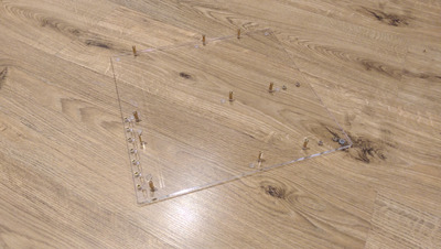

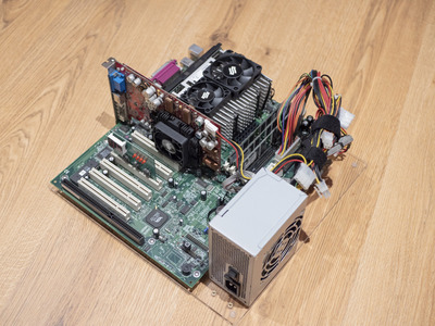

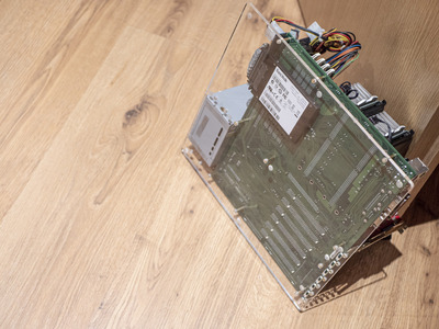

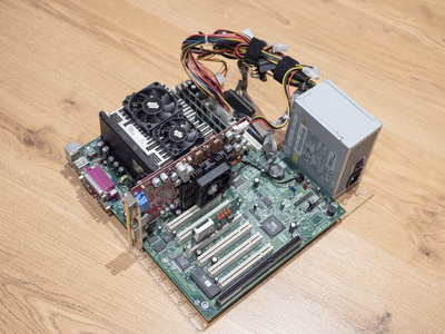

Just made a test bench for my Dual Tualatin-to be system (unfortunately i have problems with second slotket, so I installed Katmais now). I pushed heatset M3 threaded inserts into laser-cut 5mm thick acrylic base and installed standoffs. I wanted this setup to be as compact as possible, so I used SFX FORTRON 300-60GHS power supply. 22A on +5V, that should be enough. I wanted to 3d-print a mounting adapter for that PSU, but now I'm just using double-sided 3M tape to hold the PSU in place. It is so strong that I can pick up entire test bench by grabbing only the power supply 😀
Mobo is Tyan S1834D.
(red-ray if you are reading this - i will test your beta SIV version when I get Tualatins to work 😀)

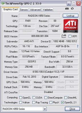

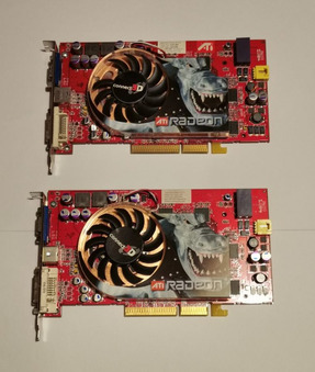

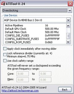

I've been playing with two x850 Pro Vivos.
Connect 3D with 1.6ns memory, and other with 2.0ns. Both unlockable to full 16 pipelines 😀.
Although GPU-Z says 12 shaders, 3DMark score shows ~22% improvement in multi-texturing (5419 MTexels/s -> 6636 MTexels/s), so I guess it works.
Procedure is fairly simple:
1. dump current BIOS with AtiTool or AtiTrayTools + make backup copy
2. edit BIOS with Hex editor (change one character at specific location: 1 -> 0)
3. load it with RaBiT BIOS editor and save it as new rom file (this fixes checksum)
4. flash new BIOS with atiflash
5. load new driver after reboot (no re-installation of drivers needed)
I've also tried with X850XT BIOSes, but run into stuttering issues in games and also fan curve issues.
It seems best scenario is to mod card's original BIOS.
I plan to pimp up first card with Zalman VF700 and memory heatsinks.

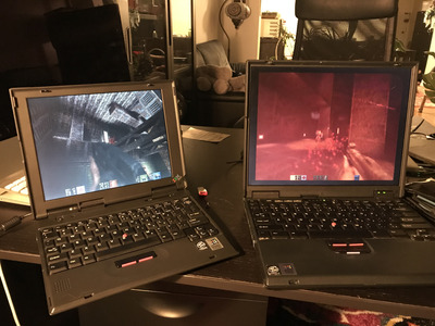

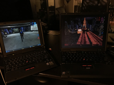

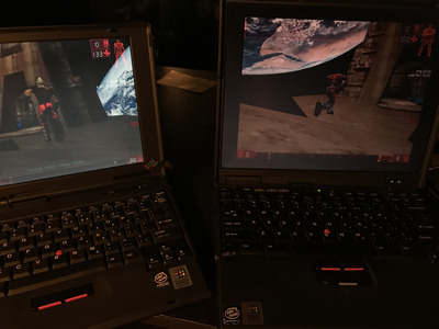

The Thinkpad T21 came back to life miraculously over the weekend, and I ran some comparisons between it and its older, slower slimmer sister the Thinkpad 240.
Turns out that the 240 is more perfomant than originally assumed. A Celeron 300A isn’t a slouch, and all the noise about the Neomagic Magicgraph 128XD being slow and unable to run lower resolutions in DirectX software mode? Bupkis.
Here it is running UT99 at 400:300x16 software mode, high quality, spectator mode with 12 bots - compared to the Thinkpad T21 running 800x600x16 running at Metal mode, the rendering speed is nearly identical, that is, FPS in the mid-to-high 10s to low 20s for more complex levels. Note that both machines have sone serious bottlenecks:
The TP240 uses a 128XD, which is a 128 bit 2D Accelerator with only 2MB of embedded EDO DRAM and is connected to the PCI bus. It wasn’t super-fast even when new.
The TPT21 has the S3 SavageIX, which is a re/spun Savage3D with one texture rendered per clock cycle, runs at 95Mhz, has a 64 bit data-path to 8MB of embedded DRAM, and is designed to be merely feature complete and power sipping and not quite performant. It’s also driving a 1400x1050 TFT panel.
The performance in Metal isn’t great but it’s rendering quality is very decent. If UT99 ran in Direct3D the texture lighting is ignored and the game looks a bit odd.
A Rage128 Mobility with 16MB of VRAM (full 128 bit datapath) will run at almost 50% higher frame rate compared to the S3, but only at Direct3D.
Here’s DM-Crane:
1.04 MiB
1321 views
UT99 DM-Crane
And CTf-Face.
1.07 MiB
1321 views
UT99 CTF-Face
Here’s Quake2 running at 400x300x16 in software mode on the left compared to 800x600 in hardware accelerated mode on the right. Timedemo is around 26fps on the left, and almost 40 on the right. A 400MHz version of the Celeron will be roughly 2-4 FPS better.

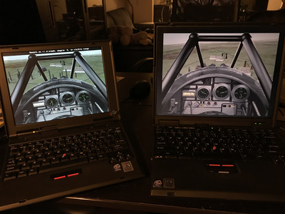

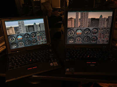

Then there’s testing VESA rendering acceleration for 2 games that are notoriously picky about it - MS Flight Simulator 5 and Rowan Flight sims like AirPower.
Within MSFS5 the S3 SavageIX in the T21 does not seem to work well using S3c911 drivers, while the Neomagic works well with VESA one - in fact, the flight model for the T21 seems glitchy and the Cessna will lawndart onto the streets of NYC within 20 seconds, while the 240 is perfectly controllable. Within AirPower both are perfectly playable, but the Neomagic seems to be a little more responsive on the flight controls.
FS5 - Flight down Broadway scenario
1.2 MiB
1321 views
MSFS5

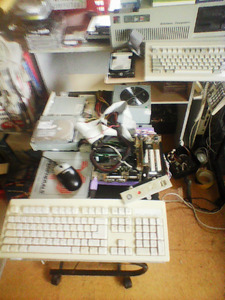

Did did a few bit n pieces over the few days. More sorting and tossing out shit I'll never use which got ris of teo large cardboard boxes. Built up a new test bench system around aslot 1 Celeron 400. Have a PII and PIII cpu to test out. Have a pci USB 2 card, pci sata card and wifi card to put in it. IT has 1 isa card in it bit I don't know how useful it will be. But the mobp runs great.
Did some soldering to wires to an from a 386/486 era front control panel. I'm using a PSU the was designed fo AT and ATX mobo. I have a couple spares as well. An AGP video card is fitted. I can roll the test bench out from under thesmall table when I need to fit components t0 test. Everytihng, apart from the video card, is built in to the mob0 and has serial/lpt ports for chatting/connect it to older systems. I used Xandros 2 linux to test all the components because it is far easier then using a win9x/ME/NT/win2k hdd where you have to go and fectch divers. Everthing worked fine.
Matched up all the cpu heat sinks I have to suitable fans removing the old heat transfer grease in the process. On pentium had stuff as bakerlight I used a belt sander to get rid of it. Found spraying with CRC 5.56 made the job real easy on most of them.
