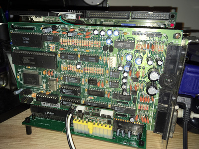

I've been having fun today with getting my Soundblaster 2.0 knock-off to have CMS sound. It works with the same CMS GAL as described here, pinouts are all the same 😀
The first GAL16v8 I bought was a used one, which was a mistake because pin 3 on that chip didn't work, which lead to patchy / single channel CMS audio. The fresh GAL16v8D came in a couple of days ago, .jed file made and flashed onto the GAL.
After that, just remove the CMS jumper, install the chips and it works. I've only tried it in KQ1 so far, but it sounded good with really nice stereo effects.

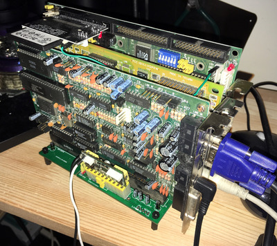

With that, I had a good reason to test out this PCA-6134P SBC I bought last week. A cacheless AM386 SX-40 made in around '96 that takes 72-pin SIMMs for memory. It even has LBA support in the BIOS 😀 To start with when I plugged it in, it seemed to be cutting out, that that was just because I'd set the bench PSU current too low and it was detecting a brown-out and shutting down. The CMOS battery on the dallas chip block is dead but the board appears to be working otherwise.
This little PC has it all, motherboard, CPU, DC-DC PSU, IDE, floppy, parallel/serial then graphics and soundcard in this fairly tiny space of 190 x 150 x 80 mm

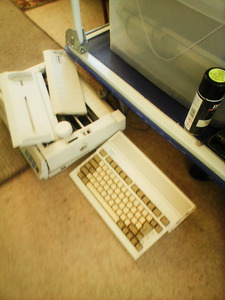

Cleaned up the dot matrix printer and Amiga A600s plastics. The Amiga was very yellowed.

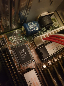

Ahhhghh
So thats why it wont start...
Edit: If anyone have a picture of the area around/under the battery on a Opti-495slc board it would be very appreciated. some traces are gone.

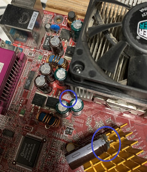

Recapped my first motherboard today! Well, first successful recap. I practiced on a cadaver board first. Didn't work before or after.
This board (m7ncg 400) sort of worked before, which was amazing to me because all of the 3300uf caps had nearly lifted themselves off the motherboard within a day after powering it up for the first time in years. Didn't like being woken from it's long slumber, I guess.
208.45 KiB
1195 views
There is a spot for a 5th 3300uf capacitor on the motherboard that was not occupied. I see that it would block the heat sink. Any chance the board would be more better with an extra capacitor or would I kill the patient?

UH19 now has 10 different identified OPTi 495SLC boards to choose from. More info would be welcome I think.
https://www.ultimateretro.net/en/motherboards/?chipsetId=375

Ahh thanks, it is this http://www.win3x.org/uh19/motherboard/show/1487

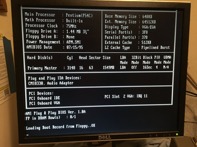

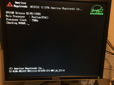

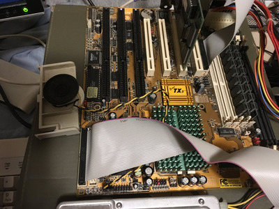

I worked on a Amptron PM9100A over the last few days, was dead and now it works. Had broken+shorting SIMM socket plus some other minor stuff.
Only thing left to do is flash the BIOS to newest version and find proper Serial/LPT back plate.
Did find a Video back plate that works with the onboard header so do not need to use a PCI card but probably will when/if I build a system out of it.
