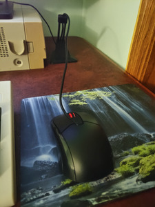

4:00 AM Post! Retro computers make the insomnia laden nights feel much cozier.
Anyway I picked up this cheepo PS2 mouse on Amazon yesterday and MY GOD, what a improvement this is over the 3 button serial mouse I was using prior.
Crank PS2rate to 200hz and I can aim in Quake again! 😁
1.32 MiB
1158 views
Allmost as good as I do on my modern PC! (of which iv gone wireless with my mice and have no plans of going back).
Reminder: a mouse bungie is a absolutely great investment too! No more lazy-cord or cord drag screwing up your shots. I wonder how resources intensive such a smooth mouse rate is on a MMX machine though
