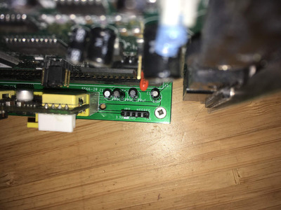

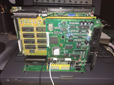

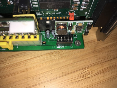

I was testing out my Reveal SC100 / Aztech Sound Galaxy BX II and the FM worked, but digital audio didn't and I thought it was broken. My two 'testing' setups are both using risers that I designed and PicoPSU supplies - which have no -5v.
Doing some more tests with digital audio, it was there but really quiet, even though FM was regular volume. So I looked at the back of the card and yep, it has a big trace to -5v on there 😀
The tall riser I made, I designed it with the intention to put a negative voltage regulator that goes from 3.3v to -5v and use that for the -5v rail on the riser. I fitted it at last and now the digital audio is working on the SG BX II. Oddly, the audio quality is kind of muffled compared to my anchor electronics MF-002 sound blaster clone card but it does work, and the negative regulator add-on didn't fry anything.

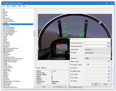

My retro activity for the day was expanding my custom DOSBox frontend to allow configuration of DOSBox mixer levels (mostly so I could set the PC speaker volume to 10% easily, when I want to play DOS games at night without annoying the neighbours or my housemate).
    46.52 KiB
    591 views
    Screenshot of my frontend's DOSBox options window

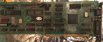

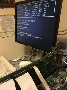

Last night grabbed a ISA card from my "need to work on" pile to try and get working. Is a DFI MIO-400AF, a HD, Floppy, multi-I/O + Mono Video 1990 16bit card.
Have had it a long time but recently was not working proper. Would not properly initialize a HD (BIOS "controller error") and serial port would not see a mouse.
The 8 DIP switch pack must have had some inner corrosion because after spray with cleaner and flipping them switches a bunch everything is working.
Only thing did not test was the Mono vid port. Cannot even find one on Ebay so maybe a bit rare or others had same issue and tossed them ?
Sorry for the poor Q picture of the card, was fairly dark and my iphone does not like low light....

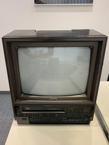

PTherapist wrote on 2021-01-17, 17:29:
CMB75 wrote on 2021-01-16, 18:12:

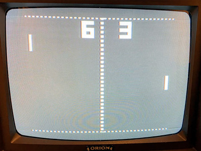

Tried to hook up my 1977 Pong clone console to an older generation LED TV ... didn't work that well. I guess I'll have to search the storage for some older CRT style TVs.
On the bright side - convinced my daughter to play some ATARI 2600 games with me. We had a lot of fun for a couple of hours. Never underestimate the generation z...
See if you have an old VHS VCR and try connecting the old console to that instead, rather than using the TV's tuner. I have to do this on a couple of LCD TVs, as their onboard Analogue tuners are rather poor, the VCR bypasses this and gives a usable picture.
True, I grabbed the most beaten up TV combo from storage and it worked "out of the box".
133.7 KiB
327 views
490.42 KiB
327 views
I guess I will do a RGB mod anyway as the R10 9010 is build upon the usual 70s suspect - the AY-3-8500(-1).

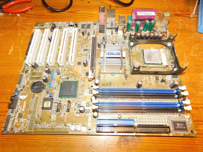

I replaced a bad cap on an Asus P4P800 motherboard I found in a dumpster find.
684.23 KiB
250 views
Asus P4P800 with a bad cap.

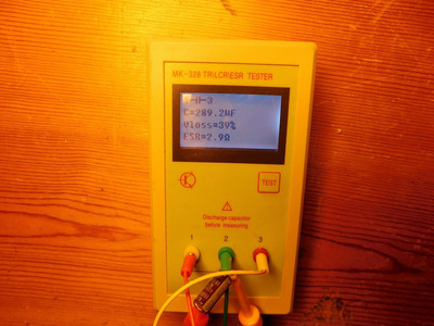

The 1500uf 6.3V cap was just a rotten as it looked. I repaced it with a cheap (low ESR) Panasonic FR series cap. I will use these wherever I think I can get away with using them.
373.52 KiB
250 views
Rotten cap.

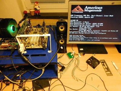

The motherboard seemed happy enough with the new cap when I tested it on my test bench setup.
443.03 KiB
250 views
Asus P4P800 test

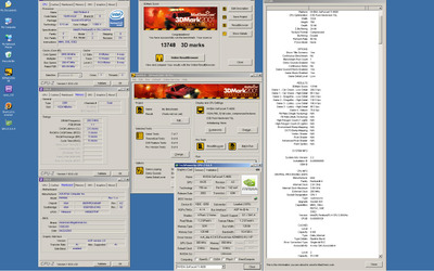

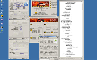

This Asus P4P800 is a really early Intel Springdale (865PE) board. The boards bios was dated April 22 2003, this is two weeks before the chipset was released so this board is probably from the very first batch.
357.13 KiB
250 views
3dmark2001 run with P4 2600C, release BIOS.
The board would not run any really decent FSB overclocks, probably not because of decaying caps but because the first batches of Springdale chipsets really were chips that diddn't qualify for the higher end Canterwood bin. Later when Intels yields were better they probably diddn't bin the chips at all and just stamped different names on them without testing/binning depending on what they needed. The only difference between Springdale and Canterwood is some sort of identifier in the chip-package so the Intel BIOS-code would know if ECC and the memory acceleration technology PAT were allowed or not, this code was later hacked to allow PAT even on Springdale.
The board could do just over 260 MHz FSB using the 3:2 memory ratio, 258 MHz FSB using the 5:4 memory ratio and 248 MHz FSB using the 1:1 memory ratio with some 512MB Samsung TCCD sticks and the P4 2600C CPU I found with the board. I updated the BIOS to the latest beta but the result was the same. I'm confident it's the chipset that reached a brick wall as the CPU would not scale with increased voltage at all.
I also tested a P4 2800C from another dumpster find and the P4P800 had no issues with running this CPU at 3500MHz using stock voltage.
360.33 KiB
250 views
3dmark2001 run with P4 2800C @3500, updated BIOS.
