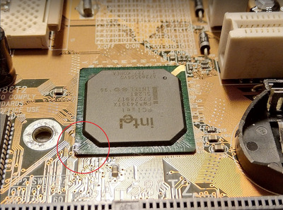

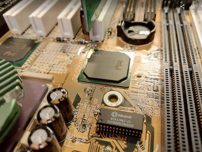

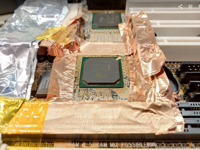

Today I replaced FW82439TX chip to Gigabyte GA-586T2 motherboard. Old chip had a lifted corner what occured as memory fault. Fortunately 3 pads were torn off from the BGA - not from the motherboard.
NOS chip from AliExpress. Baked it for couple of hours @80-100°C. Table stove as bottom heater. Slowly increased temperature on heating gun until chip temperature was about 200(ish).
I had absolutely no clue wheter it was soldered or not. Under microscope it looked OK and it does POST! Next - beer.

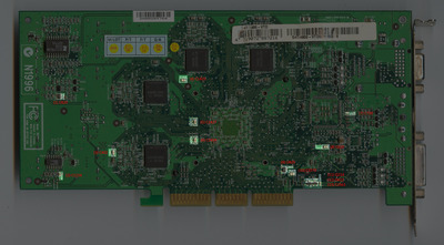

Today I received the MSI GeForce 4 Ti 4600 that I recently bought.
When it came out of the package, it was the most disgusting piece of hardware that I have ever seen. Previous owner must have been a heavy smoker, the smell was unbearable. The heatsink and fan were full of dirt. So before even inspecting the card further, I gave it a good wash in the kitchen sink.
Now it has dried, the smell has fortunately disappeared, so it was time for closer inspection. Turns out: It has a total of 13 SMD components missing on the back side. Mostly caps, but some others too (labelled with U, Q and D). Most of the solder pads are gone, too - so this will be challenging to repair.
On the front side, "only" two of the bigger caps are missing and should be easy to replace.
Here's my "inventory" of missing parts (not a photo of my acutal card, obviously):
805.1 KiB
1622 views
Missing Components
(1)		U820
(2) C1234
(3) C402
(4) C1425
(5) C1427
(6) C1434
(7) C720
(8) C610
(9) U825
(10) C1570
(11) Q214
(12) D622
(13) C1561
Edit: Weird. On my card the solder pads for U820, U825 and Q214 look like they have never been populated in the first place. But all photos that I can find of the backside of the 4600 PCB online do show these components populated. On my card it looks like they had forgotten the cutouts in the solder mask, there's not even solder on them (like there is on most other unpopulated pads). Just the oxidized copper.
