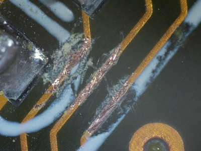

I just had a really not-fun but truly retro activity last night and this evening. I decided to swap over my Voodoo 5 Tualatin PC from my Abit VH6T in an ATX case, to the Micro ATX Chaintech 6VIA5T in an In-Win D500 MATX case. Which was funny since the Voodoo 5 actually hits the floppy drive in its regular position so I had to move that under the CD drive. Then the Voodoo 5's power cable hits the case... side angle molex connector the rescue.
Unfortunately for the VH6T, while taking off the CPU cooler at a bad angle, my flat-bladed screwdriver slipped and hit some traces around the CPU, which sliced neatly through them.
230.72 KiB
1431 views
Cleaning up the traces with a sharp knife, they may have worked at this point

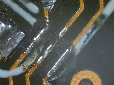

repaired
The Abit VH6T is quite rare these days, so I was extremely worried when after that repair, it still wouldn't post, giving C1 on the post card. I was very worried that I had killed a 'unicorn' in my collection.
I tried again with a different CPU and video card after work today, but noticed that there was one very leaked cap by the AGP slot that needed replacing. Now it posts, what a relief.

While taking off the CPU cooler at a bad angle, my flat-bladed screwdriver slipped and hit some traces around the CPU, which sliced neatly through them.
Great work! What a relief
We've all been there, I killed a ATi Radeon 8500 AGP by trying to prise the heatsink off with a flathead screw driver, slipped and hit all of the tracks that connect the GPU core... Also when removing a Geforce 4 Ti4600 I left one of the RAM latches down, it pulled off a chip on the card which was so small. Managed to find it at the bottom of the case and got a friend to solder it back on, it worked! (Back in 2003/4)
