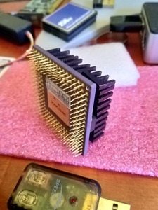

I hate bent pins. This DX4ODP100 was utterly mashed up. Managed to get almost everything reasonably straight when this corner pin S17, ADS, broke 🙁
127.15 KiB
1565 views
Might be able to sort of fix it, but at best this will now be a fragile CPU to gingerly lower into a socket once and keep it there :'(
Reply 18481 of 27502, by wiretap
The picture is a little blurry, but it looks like there's still quite a bit of metal there to solder in a new pin. Luckily, corner pins like that are the easiest to solder since you can hold your iron off to the sides without touching other pins.

Reply 18485 of 27502, by dionb
wiretap wrote on 2021-03-18, 14:51:
Yes, that's why I'm optimistic I can fix it. Ideally I'd use an interposer so I can keep the dodgy connection in the same socket all the time. Does however somewhat defeat the purpose of the ODP to use an interposer after all 😉
