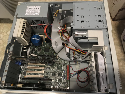

That's a nice micron PC and the civ 2 CD is a nice bonus. Does it have the cylindrical micron heatsink?
Thanks ! Yes has the original Micron blue screw on heatsink. Here is the picture before going thru it before powering on, you can see the HS had slid part way off the cpu....(my phone takes fuzzy pics)
Someone had stored it very well. Am amazed everything works as new being that old AND not be used for so long.

That's awesome I loved the look of those and their performance was quite good as well. That system looks like it was just purchased new. The previous owner really must of taken good care of it.

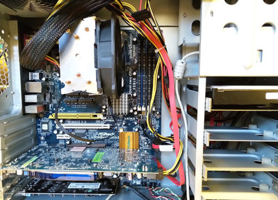

Build a slightly overkill socket 939 Athlon 64 rig from components lying around:
-Asrock 939dual-sata2
-Athlon 64 3500+ Manchester @2700
-4GB DDR400
-Sapphire HD3850 AGP 512MB
-Windows XP 32-bit
-Seagate 200GB SATA
-Sony DVDRW Optiarc LightScribe SATA
-3D printed I/O shield
I categorize this my fastest retro build because of single core and AGP. Runs easily @2700. This board has an interesting future CPU port, card is not easy to find but I might get lucky some day 😀
There were some issues though. SATAII port didn't recognize HDD, I didn't try different drive so it just might be picky. Also couldn't hear audio from onboard AC97 Realtek 850 so I had to use SB Audigy SE what was next in line. I remember buying A64 3000+ when these were new, later it was upgraded with some Opteron 2x, probably 180. Too bad I sold those when upgrading to AM3 Phenom.

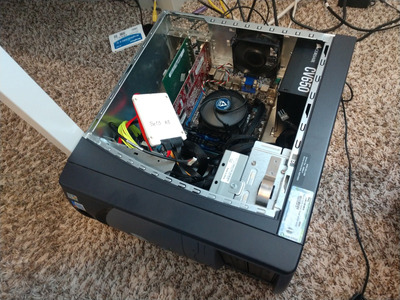

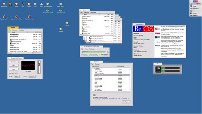

I built up a Sandy Bridge Core i3 in an old Dell case to experiment with BeOS R5. Here are the base specs:
Core i3-2120 (3.3 Ghz, 2 Cores, 4 Threads)
Asus P8Q67-M Micro-ATX Motherboard
4 GB DDR3-1333 RAM
Sound Blaster 64 PCI Sound
Generic NEC PCI-E 5-Port USB 1.1/2.0 (OHCI/EHCI)
2x 24x DVD+/-RW Drives (SATA)
KingDian 32 GB SSD (SATA)
Corsair CV650 Power Supply
This is turning into a bit of an idiosyncratic machine. BeOS refuses to boot if I specify a PCI or PCI-E video card as primary, but it will boot if I set integrated graphics to primary. If I have a Matrox Millennium installed (either in a PCI slot or PCI-E to PCI adapter), video on the integrated graphics freezes and BeOS switches to displaying out of the Millennium after the boot-up sound. It does this with my GeForce 6800 GS (PCI-E) as well, but the 6800 doesn’t put out a display (just a blank screen). I haven’t gotten any other PCI-E video cards to work at all.
I reprogramed the BIOS a couple of years ago to add a 1080p VESA mode to the integrated Intel graphics. It works with most generic VESA drivers in other operating systems, but it never displayed 1080p properly in BeOS when I used a VESA mode setting patch (it would only produce a 640x480 desktop in the upper left-hand corner of the screen). Today, though, I discovered that I can get a proper 1080p desktop (see screenshot) from the integrated graphics if I set “Use Fail-safe Video Mode” from a BeOS safe-mode boot menu. Weird!
Now, I’m waiting on a NOS PCI network card to arrive so I can get this modern BeBox online.

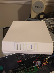

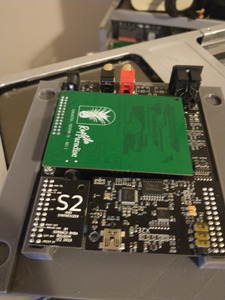

I made a generic Midi enclosure for my DreamBlaster stuff.

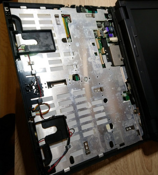

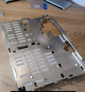

I cleaned up (most of) a really moldy Thinkpad 770 today. It works!
Before:
178.36 KiB
1325 views
After:
178.25 KiB
1325 views
Tomorrow I'll clean the absolutely horrible keyboard and try to install Windows 98 on it.
