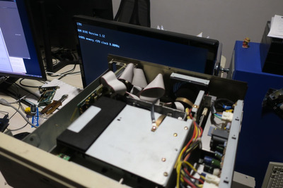

Finally upgraded the oldest system I have (a Sanyo XT MBC16PLUS1) to VGA using a Trident 16 bit ISA card (thanks @Tiido for the help on the 8-bit modus).
87.41 KiB
1157 views
The card has now more VGA ram than memory, 1 MB vs. 640 kb. Still stuck at boot though, there is an issue with the MFM drive or its controller, but I'm not sure how to troubleshoot this.

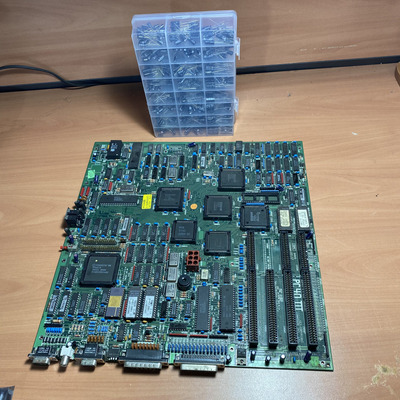

Going to attempt putting a regulator on a GA-486VS Rev. 8a
And recap a Commodore PC 40 III motherboard.

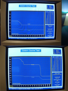

I checked my 486s for caches using Celem Cache Test, which I had never heard of. It says my 486 AMD DX 100 is running at 86 MHz, where as HWINFO states it runs at 100-ish MHz, so I don't know what's going on.
    1.03 MiB
    1612 views
    SX 25 is my Zenith, the other my AT&T
