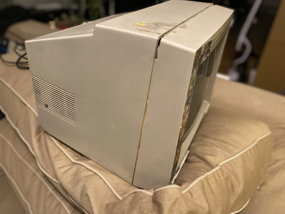

Reply 18926 of 27716, by seleryba

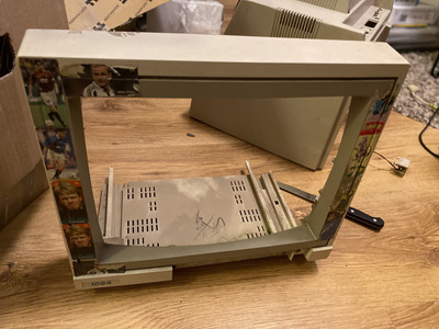

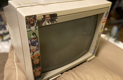

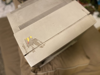

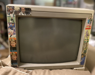

Finally I found some time to do the retro things, so I had a busy Friday.
Last week I've bought the Commodore 1084 colour display. It was awful visually:
747.14 KiB
1073 views
687.28 KiB
1073 views
1.32 MiB
1073 views
1.01 MiB
1073 views
so I decided to don't hesitate and start the restoration of this one.

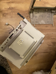

In progress. I always use some car APC cleaners for restoring and cleaning plastics.

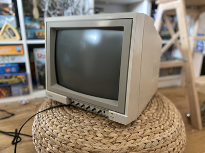

Reply 18928 of 27716, by seleryba

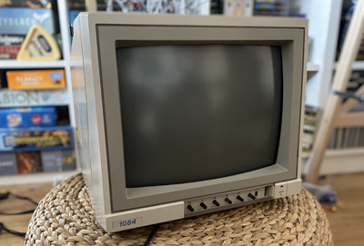

And how it looks now:
1.09 MiB
1066 views
707.6 KiB
1066 views
1.66 MiB
1066 views
I need to buy or make the front flap.
Also I will replace internal mono shitty speaker to the good stereo ones from iMac G5.

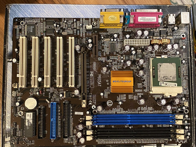

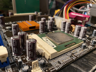

After that I decided to do another retro restoration - recap of the one of best motherboard with PGA370 - ECS P6S5AT. Famous SiS 635T inside.
Cleaned the board deeply. Then I've replaced capacitors with top-notch Nichicon PW and Panasonic FR series. Now this board should be stable as rock (pun intended), its condition is better than in 2003 😉

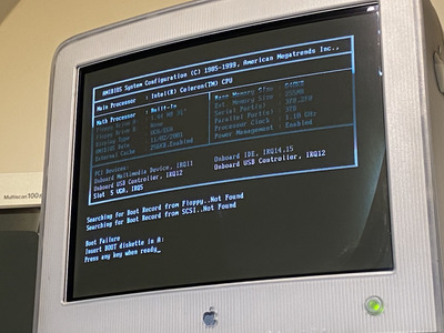

Reply 18930 of 27716, by canthearu

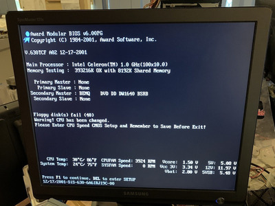

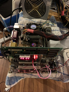

What would you know, I was also recapping a SiS 630T board today to revive it (Jetway 630-TCF). Was not posting at all yesterday.
Not nearly as nice a board as that one, but again, I replaced the old GSC 6.3V 2200 and 1500uf capacitors with top quality Panasonic FS series 2200uf 16V capacitors. I also changed 3 x 1000uf 6.3V capacitors with Nichicon caps I pilfered off another dead motherboard.
And success, the thing boots and is stable as they come, probably already in better condition than new.
215.7 KiB
1044 views
175.26 KiB
1044 views
Now, since this will be job for a customer, I'll change the 1000uF capacitors with new ones at some stage, I didn't want to actually spend money on the board until I saw it working. Now it is time for a more complete recap. I think I'll leave the 2000uf capacitors in there, even though they are higher voltage and capacity than needed, as they are doing a great job.
Reply 18931 of 27716, by liqmat
seleryba wrote on 2021-05-08, 12:20:
And how it looks now: […]
Awwww... What happened to all the pretty stickers? Nice work.

🤣 Greetings from germany to poland!! You did a very good job cleaning that monitor!

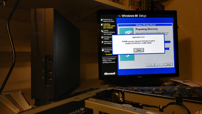

speaking of IBM
been trying to install Win98 on this NetStation without floppy or CD-rom...
I've been duped into thinking I'd buy a 266MMX with it, seeing as every resource online I found referred to it being specd with a 266MMX, was the reason I got it in the first place, but of course there's only a 233MMX in it 🙁
...rather unsuccessful so far x3... guess I'll have to hook up a CD-rom with external PSU (I don't have the cable that plugs into the MB) after all.
