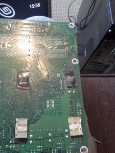

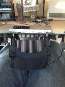

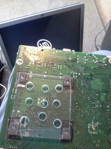

Wasn't too sure where to put this so here goes. I needed to make a heatsink retainer for my Pentium 4 4.something GHz mobo. I know everybody hates P4s. Got some lexan sheet and cut that to size, superglued some captured nuts then put some extra holes in the lexan for more ventilation. Enlarged the mobo mounting post holes for extra thread length in to the nuts and though the lexan. The lexan plate is held on to the underneath by a piece of thin rubber that sticky tape on both sides with a drop of super glue for good measure. This is so it stays with the mobo when the heatsink is removed. Came out rather well and the case it is going in has a nice indentation where the plate will be located so it wont interfere with standoff fitment.

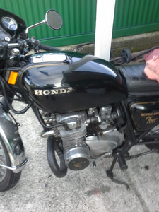

Got a 400ml can of custom matched black paint from Resenes Automotive so I could tidy up the back half of the fuel tank of my motorcycle. It had a chunk of caprithain had been pulled from it by that scuff resistant plastic sheet when I removed it. The motorcycle is a 1976 Honda CB550F Super Sports I've owned since 1986. The job came out rather well if I do say so myself 😉

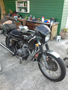

Here's a better veiw of the ol gal:
