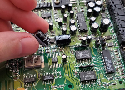

I needed to install a PCI card that has a fan on it next to an ISA slot with a Sound Blaser. Unfortunately, this particular Sound Blaster has a very large capacitor that interferes perfectly with the fan blades. So I removed the capacitor and added a new one that I've laid down on its side.
The original capacitor is labeled as an "SMG" series, which I think is an original Nippon Chemi-Con. I just used a cheap Chinese capacitor as a replacement. Does anyone know if there is any reason to use a more expensive cap here? I feel like even a cheap capacitor from today should be just as good or better than a good capacitor from the early 90s.

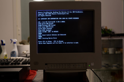

Story continues. When I got this monitor, it was dead (power led lit, no image). I revivied it by recapping the neckboard. It didn't fix all the issues. Image was still brighter on the left side of the screen, but good enough for use.
I guess that calls for recapping the main board too. Back then I was happy just to get it working, and didn't bother with complete teardown to access the larger pcb. Now I started working on it. It took 26 screws to take it apart. It has 45 capacitors. I assume they are all equally bad or going bad soon, so I'm replacing them all.
And after recapping, it was a pleasant surprise to see it still works and the annoying glow on the left side is gone. Took me two evenings to do it. Most laborous recapping I've ever done, but worth it 😀
I wasn't very optimistic this would do anything at all, because all the caps looked ok and they were all good brands (Nichicon, Rubycon etc.). Top of every capacitor was intact and flat. When removing them from the board, I noticed some of them had bursted downwards. Now this monitor has all brand new caps, and hopefully long life ahead of it.
I suspect this monitor wasn't used for very long. It was so clean inside with only minimal dust, and the tube seems like new. Assembled November 1994 in Scotland.

Nice job saving that monitor. From the picture it looks like it has a nice bright and crisp image.
I wonder, has anyone ever tried recapping one of those ISA Sound Blaster 16s with audio-grade capacitors, like Nichicon FW series? I feel like those cards have a lot of potential.
Reply 21231 of 27549, by Kahenraz
All of my Sound Blasters are working and none of the capacitors are bulging. There may be improvement to be had, but generally the samples they play are poor enough that I think it would be hard to tell.
Outside of DOS, I always pair this card with a PCI card for Windows, so it's never truly an issue for my use case.
