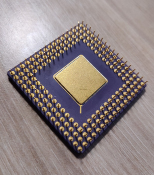

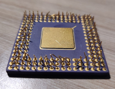

Reply 22320 of 29860, by NyLan

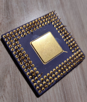

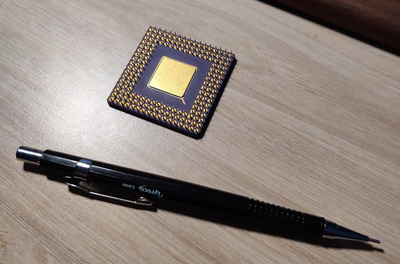

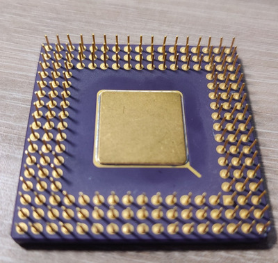

It's not that long but need to take your time ! 😆
I mainly use a mechanical pencil because the hole for the lead is almost the same size as the processor pins... and a small scalpel when the pins are too close together.
The attachment 2022-08-03 14.57.19.jpg is no longer available

Reply 22321 of 29860, by Kahenraz
Yes! I can fixed hundreds of bent pins like this. The Mechanical pencil trick works perfectly.
It's especially effective because you can move the opening up and down the pin to tweak it just where you want it.

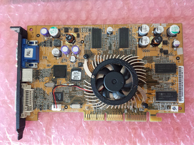

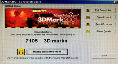

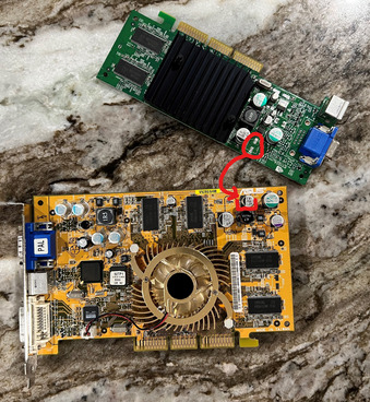

Certainly not any miracle work like others perform around here, but I saved this Asus V9280 AGP 8x Ti4200 64MB from the "recycle bin." I bought this on eBay some while back for $28.00/shipped from Ukraine. The seller advertised and demonstrated it worked, but it was missing a capacitor. When it arrived to me, it no longer worked (They packed it just fine). I did try to replace the missing capacitor, but the card still didn't work. I didn't ask for a refund because it was a gamble. Usually I win, but not this time, so it seemed.
Anyway, I put if off to the side to attend to later. Today, I searched through a small pile of my broken cards for another capacitor after comparing the Ti4200 to a working one online (I'm guessing the first time I misidentified the correct capacitor to use). The donor MX420 (shown) graciously gave up the part. A short time later, the Ti4200 was back in business. No image, 2D, or 3D problems. Clocks report 252MHz/512MHz. Passed 3DMark 2001SE fine (as shown; defaults used at 1024x768 32-bit color on an Intel D815EEA using a PIII@1GHz/133MHz), passed the "Turok" test where I turn up all candy to maximum w/vsync@181fps, and the card plays DOS/Terminator SkyNET hi-res mode 640x480 with no issues.
A good day.

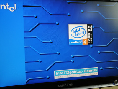

Guess what CPU I have installed today on my favorite splash screen socket 478 motherboard.

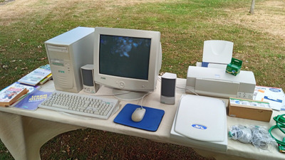

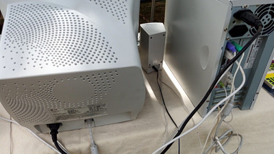

There is a listing on ebay at the moment for an exact same PC I had in 1999, same model serial too. ATi rage pro onboard, AMD K6-2 exact same monitor LG 775N. Sad to say its a six hour round trip so wont be able to buy it. Never again, same config 🙁 The only difference were the speakers, I had cheap labtec at the time...
https://www.ebay.co.uk/itm/175371351035

Interesting: Asus seems to have dropped a rather large cap from the Ti4200 AGP4x to AGP 8x variant: labeled C2301, right next to the one you repaired.
I recently fixed an AGP4x 64MB (V8420) which was missing a handful of SMD caps but also C2267. That's why I immediately thought C2301 would be still missing on your card. But apparently it was never there on the V9280. At least according to the pics in the net.

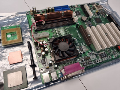

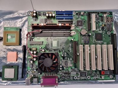

Getting ready to have some Tualafun with what appears to be the Queen of 440BX boards.

That's Inwin V700 case.
