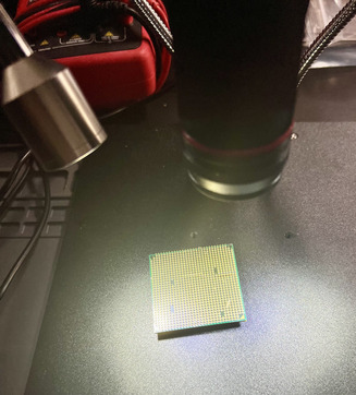

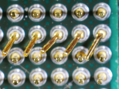

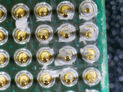

AM3 isn't that retro...but I'm straightening some pins on a Phenom II cpu I got off eBay. Previous owner also managed to get thermal grease all over the underside of the cpu...
1.75 MiB
1070 views
1.67 MiB
1070 views
1.77 MiB
1070 views

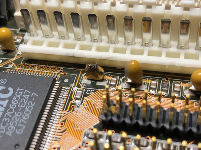

Reply 25646 of 27674, by Shponglefan
ubiq wrote on 2023-10-21, 19:53:
Tried and failed to get this ASUS P/I-P55TP4 to POST. […]
Verified voltages with a POST card, tried a couple PSUs anyway. Tried a few different (proven on other systems) CPU/RAM combos. Dumped the BIOS and flashed it with the only version I could find online. Tried it with the dead Dallas RTC in, removed, and with a Necroware replacement. Couldn't find an exact manual online, but the jumpers don't seem too terribly complicated. Resorted to trial and error... finally gave up. This one is beyond my limited abilities. 🫤
It's a little older than things I usually work on, maybe there's something obvious I'm missing?
What does the POST card say? Does it actually start the POST process and stops at a certain point? Or does it completely fail to POST at all?
Pentium 4 Multi-OS Build
486 DX-33 with 5 sound cards
Reply 25647 of 27674, by ubiq
Shponglefan wrote on 2023-10-21, 22:10:
Lol, ok stand down. I just hooked it up again to have a look and was treated to a brief moment of excitement:
1.21 MiB
1004 views
So, at the very least, I now know one thing that's wrong with this board. 😭
(FWIW, no it was never starting the POST process, just "----" on the POST card)
Reply 25648 of 27674, by H3nrik V!
ubiq wrote on 2023-10-21, 22:23:
Lol, ok stand down. I just hooked it up again to have a look and was treated to a brief moment of excitement: IMG_6099.jpeg […]
Yeah, that tantalum is definitely blown. It might even be shorting the power supply still ...
