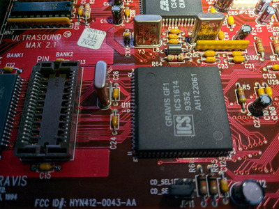

Got Gravis Ultrasound MAX 2.1 (serial 0495) which apparently requires care: setup hangs on interrupt test, impulse tracker it.exe /s7 just hangs in three different mobos/cpus/DOS'es/cards etc.
Quick inspection shows that following three crystals (by oscilloscope):
Y1 is 19.7568 MHz (Ecliptek ECX-1689) which is near ICS1614 (GF1) has 5.5Vin and no wave, seems gone;
Y2 is 24.576 MHz (Ecliptek EC246) - good and clean wave 24.5MHz;
Y3 is 16.9344 MHz (Ecliptek EC169) near Y2 - have no input voltage. Seems powered on demand via Crystal codec chip (in and out are connected from one CS4231A pin to another), according to individual codec test (which is passed), they both seems working.
Maybe fellow Vogons members point me the way to get Y1 in PM ? Are Y3 should be always powered on ?

I dont think anyone found reliable source, you might have to replace it with modern PLL clock gen like Silicon Lab Si5351A + small micro to program frequency on every powerup.

Thank you. Tomorrow I hope I will get a handful of nearby freq crystals and will check is this is an issue at all (ICS1614 may be gone too). If this is the root cause, well, it's good then - I'll redirect to a PLL way and'll learn something new.

I just remembered there is also this GUS repro project ARGUS Project thread - Now with gerbers and documentation in initial post! and I think they managed to shit ship correct crystals because they ordered custom from manufacturer with min 1000qty

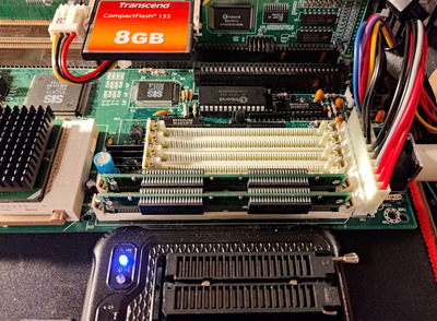

Did my first eeprom flashing today with T48.
Everything went smoothly. I can now use Am5x86 in my qdi-v4s471-g now.
I was surprised that by replacing BIOS chip all my settings remained intact. Where the hell 486 era boards are storing custom settings?

CMOS settings are not saved to the BIOS chip. The motherboard provides a small amount of non-volatile RAM to store these settings (the battery keeps it powered when you turn off the machine). There may be a dedicated chip for this, but more commonly it's integrated to the chipset. In your case, this RAM is in the SiS 85C407 chip near the BIOS.

Obviously 486 era EPROMS are only UV erasable. Never thought about that. So it's in SiS 85C407. Learned something new today...

You could also try and ask Ian Polpo if he happens to still have one:
Re: Need help repairing a Gravis Ultrasound Classic 2.4!

The ArGUS doesn't use a 19.7568 MHz crystal. Those were used as along with the original GF1 chip, which is not used on the ArGUS (it uses the Interwave chip).
Unfortunately as others have mentioned, 19.7568 MHz crystals are no longer manufactured.
