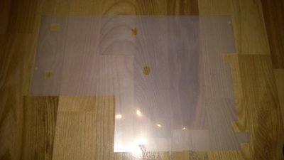

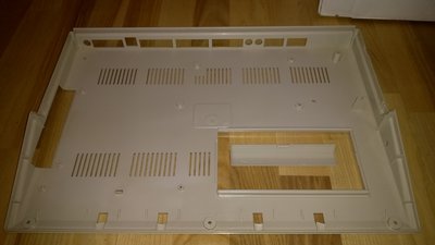

I did some more restoring of the 500.... This time, the bottom case and the plastic inlay, that goes between the bottom RF shield and the mainboard. This cleanup really took some time. It was not battery acid, though it was all rust from the RF shield. I used warm water, dishwash soap and a splash of alcohol. Used a nylon spunge and to get the last rust out that had buried it self down into the plastic, I used a small stiff knife, to scrape it off. Before it was a trainwreck, now it looks kind of decent. Still tiny traces of rust left, so I need to fix that on a second run. I think it took me 3 hours or something like that. My hands are itching and are extremely dry now.

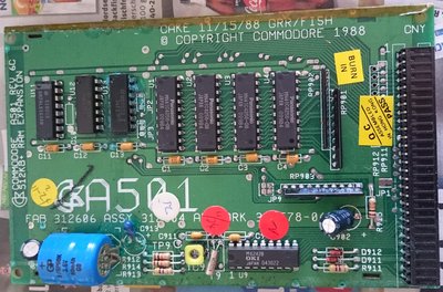

Hi brostenen, I am currently also caring about my 3 new Amiga. Completely disassembled and cleaned them. I never owned one and I am surprised how repair-friendly they are. The 1st one looks like new now 😎
Mainboards seem to be OK except the one in the A500+. The battery started leaking and all caps seem to be bend and partially broken. Will need to replace them.
1.22 MiB
934 views
Today I will care about the A501 memory expansion. There seems to be a battery inside and you can already see the green residue everywhere. Have to desolder to open the metal case.
226.43 KiB
934 views
361.99 KiB
934 views
Reply 9046 of 27554, by Predator99
^...already disassembled:
753.66 KiB
919 views
Does indeed not look good.
After the 1st cleaning run its better:
634.83 KiB
919 views
There is liquid below the 1st PCB layer but I think I will leave it as is at the moment. When removing it will not look good anymore. I also expect the 74F27PC needs to be replaced...

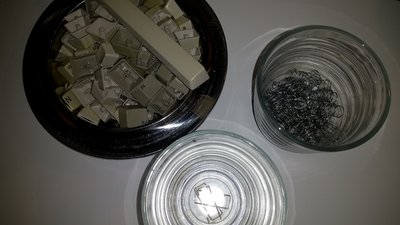

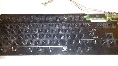

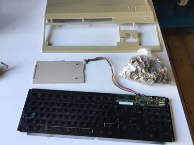

The journey continues. The old lady had her buttons cleaned and had them put back on. When replacing the keycap's, I took notice that the Caps-Lock diode is a red one. I was under the impression that they used to have a green diode on the Caps-Lock. I know that the old keyboards used green and red diode. And that Commodore at somepoint changed it to green and yellow. Shure I know that the old chicken lips keyboard had a red diode, yet those are rare keyboards, and they are the only ones that had mechanical keys. So I am really surprised to find a rubber dome (with springs), that has a red diode in the Caps-Lock key.
Anyway... From nasty to acceptable. I really do not want to take the entire keyboard apart if it is working. For now, a good surface clean will do. Here in Denmark, they add something to the rubbing alcohol, that makes one sick if one drinks the 97/98 percent proof rubbing alcohol. It leaves a kind of sticky resedue, and is perfect to clean keyboard springs in. I think it will prevent more rust from forming. So I have used it to clean the springs.
406.86 KiB
838 views
439.48 KiB
838 views
391.66 KiB
838 views
One fine acceptable keyboard, will test if it is working, once I get the board back in the case.

The keyboard is dead. 🙁 Tested it with systest. So now I have to get another one.
I might find another Amiga in bad shape, and see if I can put together one complete system.
