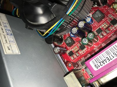

I replaced a capacitor that was on the edge of failure on an MSI Pentium 4 motherboard, chainging a bloated Sanyo 16V 1000uF capacitor with a 16V 1500uF capacitor.
781.56 KiB
1867 views
The brown Capacitor is the replacement. The green ones below it are the original Sanyo that was badly bloating.
P4's like to cook their capacitors 😀

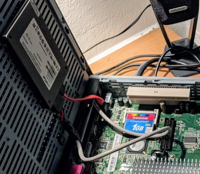

Created a USB-to-SATA power cable for a thin client PC that had an onboard SATA connector, but no SATA power connection (so I could hook up a SATA SSD without an external power supply). Turns out the SSD in question just needs the 5V connector (in general, a SATA power connector can have 3.3V, 5V and 12V lines), and the USB ports provide enough amps, so splicing together a SATA-power-to-molex cable with an old USB printer cable allowed for powering the SSD just fine.
I might still change the cable to connect directly to a unused USB header on the motherboard and take the 5V off there, since right now the USB cable goes out at the back of the case to a USB port (on the other hand, the thin client in question also has an external SATA connector (not eSATA, just SATA data), so the USB cable has its advantages if I'm going to keep the SSD on the outside of the case...
    675.68 KiB
    1626 views
    SATA SSD mounted inside the case, power via USB (going outside the case to the back USB connector)

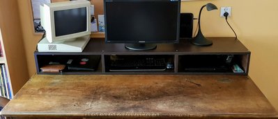

Perhaps not exactly 100% retro activity, but I finally finished wooden compartments on my desk to reclaim some space (not sure what the actual word for this is - could any native speaker help out?). Parts of it are reserved for retro equipment: Tandon 286 already in place, DOS laptop - soon, possibly also ZX Spectrum (if I manage to convert the output to small crt TV I have - would land on the top right) or the original Game Boy with modded screen. Other than that, two slots are for my work laptop (bottom left) and my personal computer (X230T - bottom right).
546.6 KiB
1374 views
Also, I should soon have new monitor, more apt for retro things (spoiler alert).
