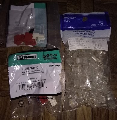

Skyscraper wrote:
To be able to test this a professional CGA/EGA 9pin to "EGA/CGA 15pin" cable is needed.
Just a wild hair of a wild thought (that I almost used and might still use for rebuilding the 8-pin DIN power cable from a Zeos 386 (got it working but haven't fully rebuilt the cable yet):
527.17 KiB
480 views
It might take two cat5 cables (you could glue the sockets together side to side) and I'm not 100% sure your wires will fit in the cable ends, they might be too large (but it's a thought). It would look a lot cleaner in the end *and* in theory you could swap out different adapters later, provided they were wired correctly.
You could... you could almost have a universal 15-pin-to-anything adapter, or at least anything signal-compatible.
*Too* *many* *things*!

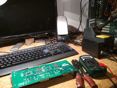

Repaired my voodoo5 5500. Got it in a lot with other cards, it never worked but now that I have a good soldering station I managed to replace the small missing CMS capacitor !
I plan to use it instead of the Geforce 4MX in my 450mhz PII build. Is it stupid to match it with this CPU ? Should I definitely upgrade for a PIII ?
Also i'm quite worried by the amout of heat it produces. 4MX was very cool, passively cooled. The Voodoo5 5500 runs very hot in comparison... is there a way to undervolt it ?
