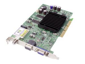

Maybe I'm missing it, but I still haven't seen do you want cloned image on two different displays, or two independent displays as your workspace. Can you provide a picture of your FX 5200 if it doesn't match up with commonly available web images of Personal Cinema FX 5200 or FX 5200s in general, please (it should be capable of supporting dual monitors).

This one is from MSI but the connectors are the same: 14-127-109-05.JPG
Reply 12 of 14, by obobskivich
So VGA should be on the break-out (like in the original picture) ++ on the card; it will do dualview (FX 5200 supports that). However you will want to disable the LCD in Windows before gaming (it'll just eliminate a lot of headache).
